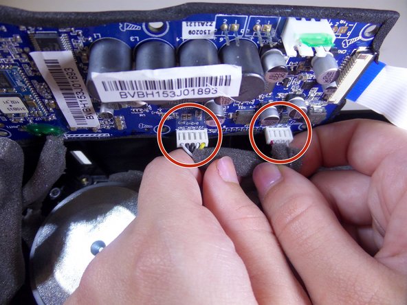

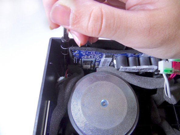

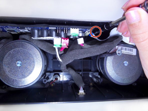

  14. Braven BRV-HD Motherboard Replacement, Motherboard: crwdns2935265:014crwdnd2935265:01crwdnd2935265:03crwdne2935265:0 Braven BRV-HD Motherboard Replacement, Motherboard: crwdns2935265:014crwdnd2935265:02crwdnd2935265:03crwdne2935265:0 Braven BRV-HD Motherboard Replacement, Motherboard: crwdns2935265:014crwdnd2935265:03crwdnd2935265:03crwdne2935265:0
    • Locating the two screws on either side of the motherboard, unscrew the two 8 mm Phillips head screws using a J1 Phillips head screw driver.
  15. Braven BRV-HD Motherboard Replacement: crwdns2935265:015crwdnd2935265:01crwdnd2935265:03crwdne2935265:0 Braven BRV-HD Motherboard Replacement: crwdns2935265:015crwdnd2935265:02crwdnd2935265:03crwdne2935265:0 Braven BRV-HD Motherboard Replacement: crwdns2935265:015crwdnd2935265:03crwdnd2935265:03crwdne2935265:0
    • Slide out the motherboard using your hands.
    • Unplug all the wires attaching the motherboard to the device.
    • Remove and replace motherboard.
    • Some wires are glued to the motherboard with a green glue. Remove the glue before removing the wires.
