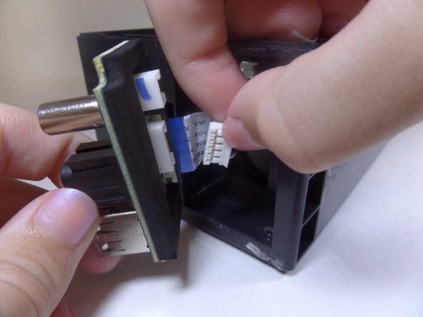

  14. Braven BRV-HD Charging Port Replacement, Charging Port: crwdns2935265:014crwdnd2935265:01crwdnd2935265:03crwdne2935265:0 Braven BRV-HD Charging Port Replacement, Charging Port: crwdns2935265:014crwdnd2935265:02crwdnd2935265:03crwdne2935265:0 Braven BRV-HD Charging Port Replacement, Charging Port: crwdns2935265:014crwdnd2935265:03crwdnd2935265:03crwdne2935265:0
    • Disconnect the three plugs attached to the plastic charging port panel.
    • Remove and replace the plastic panel with a new one.
    • Be careful in removing the 3 plugs as they can break when being pulled out of their white sockets.
