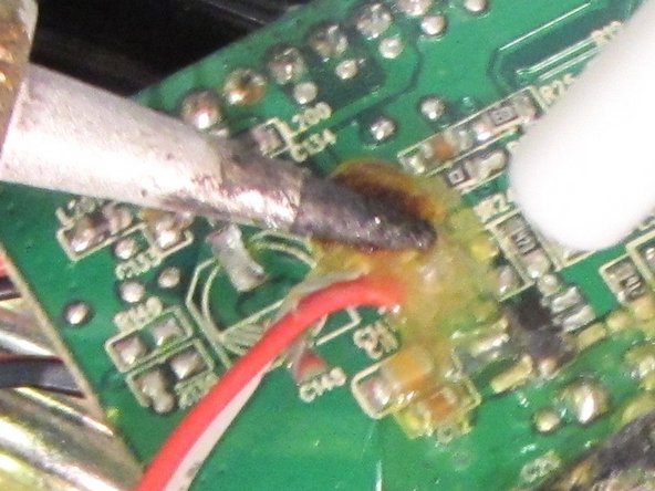

  10. Braven BRV-1s Motherboard Replacement: crwdns2935265:010crwdnd2935265:01crwdnd2935265:01crwdne2935265:0
    • Soldering irons get extremely hot. Be sure to wear proper protective wear and keep it away from exposed skin while it is turned on.
    • Turn your soldering iron on to high.
  11. Braven BRV-1s Motherboard Replacement: crwdns2935265:011crwdnd2935265:01crwdnd2935265:02crwdne2935265:0 Braven BRV-1s Motherboard Replacement: crwdns2935265:011crwdnd2935265:02crwdnd2935265:02crwdne2935265:0
    • You may wish to use a heat gun to melt any excess glue that may be holding the wires down.
    • Using the soldering gun, desolder the wires off the motherboard.
  12. Braven BRV-1s Motherboard Replacement: crwdns2935265:012crwdnd2935265:01crwdnd2935265:02crwdne2935265:0 Braven BRV-1s Motherboard Replacement: crwdns2935265:012crwdnd2935265:02crwdnd2935265:02crwdne2935265:0
    • You can also just pull up this circuit board carefully; it is easier if you scrape off the glue that is holding it to the posterior frame (arrow)
  13. Braven BRV-1s Motherboard Replacement: crwdns2935265:013crwdnd2935265:01crwdnd2935265:01crwdne2935265:0
    • Once you have soldered off the wires, remove by pulling upwards.
