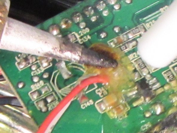

  10. Braven BRV-1s Auxiliary Ports Replacement: crwdns2935265:010crwdnd2935265:01crwdnd2935265:01crwdne2935265:0
    • Soldering irons get extremely hot. Be sure to wear proper protective wear and keep it away from exposed skin while it is turned on.
    • Turn your soldering iron on to high.
  11. Braven BRV-1s Auxiliary Ports Replacement: crwdns2935265:011crwdnd2935265:01crwdnd2935265:02crwdne2935265:0 Braven BRV-1s Auxiliary Ports Replacement: crwdns2935265:011crwdnd2935265:02crwdnd2935265:02crwdne2935265:0
    • You may wish to use a heat gun to melt excess glue around the wires.
    • Using the soldering iron, desolder the wires from the circuit board.
  12. Braven BRV-1s Auxiliary Ports Replacement: crwdns2935265:012crwdnd2935265:01crwdnd2935265:01crwdne2935265:0
    • Once you have soldered the glue off, remove the wires by pulling upwards.
