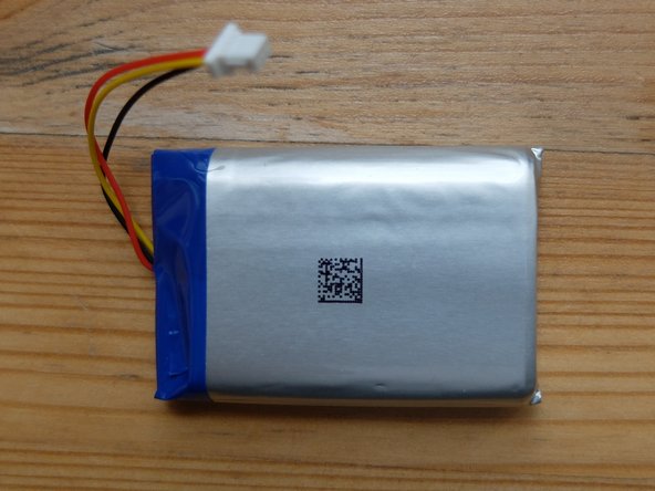

  1. Braven 625s Accumulator Replacement, Replacement accumulator: crwdns2935265:01crwdnd2935265:01crwdnd2935265:02crwdne2935265:0 Braven 625s Accumulator Replacement, Replacement accumulator: crwdns2935265:01crwdnd2935265:02crwdnd2935265:02crwdne2935265:0

  7. Braven 625s Accumulator Replacement, Remove accumulator: crwdns2935265:07crwdnd2935265:01crwdnd2935265:01crwdne2935265:0
    • You need to remove a cap and under the ribbon cable you can cut the red and black wire for the accumulator. Cut them close to the accumulator and at different lengths because later on you don’t want to have the soldering points side by side.
  8. Braven 625s Accumulator Replacement, Space for accumulator: crwdns2935265:08crwdnd2935265:01crwdnd2935265:01crwdne2935265:0
    • 50mm x 38mm x 10mm
  9. Braven 625s Accumulator Replacement, Mounting the replacement accumulator: crwdns2935265:09crwdnd2935265:01crwdnd2935265:01crwdne2935265:0
    • Cut off the white connector wire by wire. Do not cut the wires in one step to avoid a short circuit for the new accumulator because it comes with some energy inside. Ignore the yellow wire. It is the temperature sensor of the replacement accumulator and not needed here.
  10. Braven 625s Accumulator Replacement, Soldering: crwdns2935265:010crwdnd2935265:01crwdnd2935265:01crwdne2935265:0
    • Do the soldering.
