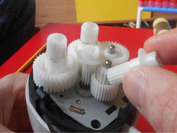

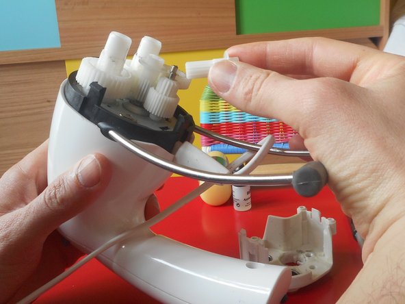

    • Pull the central gear to remove it from the crankshaft. In the picture you can see the crack in the gear that was causing excess noise.
    • Replace the gears with the spare parts. The central gear needs to be inserted with some force on the crankshaft. A small hammer can be used to get the central gear in place.
