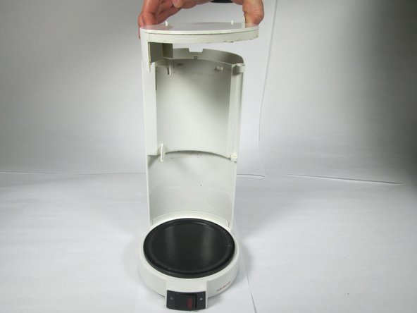

  9. Braun Aromaster KF440 Internal Tubing Replacement Guide, Remove the top: crwdns2935265:09crwdnd2935265:01crwdnd2935265:03crwdne2935265:0 Braun Aromaster KF440 Internal Tubing Replacement Guide, Remove the top: crwdns2935265:09crwdnd2935265:02crwdnd2935265:03crwdne2935265:0 Braun Aromaster KF440 Internal Tubing Replacement Guide, Remove the top: crwdns2935265:09crwdnd2935265:03crwdnd2935265:03crwdne2935265:0
    • Wedge the plastic opening tool between the back of the coffee maker and its top.
    • Once the top is loose remove by lifting up on the top of the coffee maker.

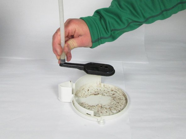

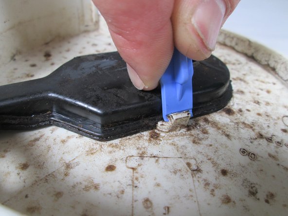

  10. Braun Aromaster KF440 Internal Tubing Replacement Guide, Remove tube from the lid: crwdns2935265:010crwdnd2935265:01crwdnd2935265:03crwdne2935265:0 Braun Aromaster KF440 Internal Tubing Replacement Guide, Remove tube from the lid: crwdns2935265:010crwdnd2935265:02crwdnd2935265:03crwdne2935265:0 Braun Aromaster KF440 Internal Tubing Replacement Guide, Remove tube from the lid: crwdns2935265:010crwdnd2935265:03crwdnd2935265:03crwdne2935265:0
    • Once the top is removed you will notice that there is a tube attached.
    • Remove the tube from the lid by using the opening tool.
    • Place the opening tool under the clasp and gently lift the plastic clasps.

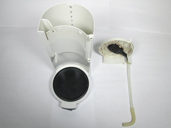

  11. Braun Aromaster KF440 Internal Tubing Replacement Guide, Detach tube: crwdns2935265:011crwdnd2935265:01crwdnd2935265:01crwdne2935265:0
    • Finally, firmly hold the tube. Wiggle the black component away from the tube by hand.
  12. Braun Aromaster KF440 Internal Tubing Replacement Guide, Tubes are ready for replacement: crwdns2935265:012crwdnd2935265:01crwdnd2935265:01crwdne2935265:0
    • You now have your tubes removed and ready to be replaced.
