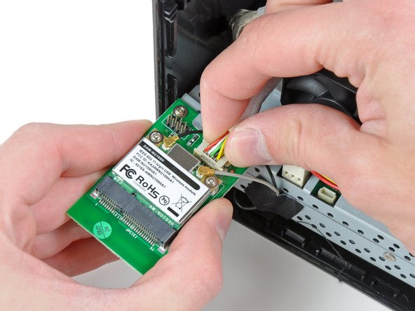

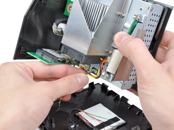

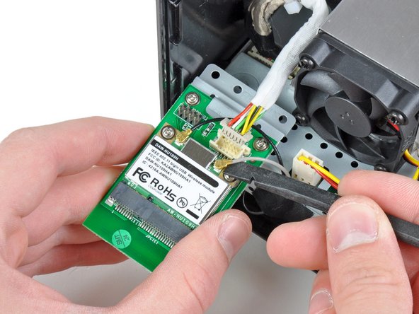

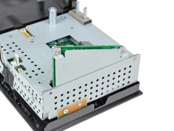

    • The Boxee Box' wireless board is secured to the metal frame by more Phillips screws.
    • It certainly is refreshing to see common screw types in electronics. When you don't need special tools to repair devices, it's easier to fix it yourself.
    • The wireless board is held on by a data connector and a couple antenna cables.
  8. Boxee Box Teardown: crwdns2935265:08crwdnd2935265:01crwdnd2935265:03crwdne2935265:0 Boxee Box Teardown: crwdns2935265:08crwdnd2935265:02crwdnd2935265:03crwdne2935265:0 Boxee Box Teardown: crwdns2935265:08crwdnd2935265:03crwdnd2935265:03crwdne2935265:0

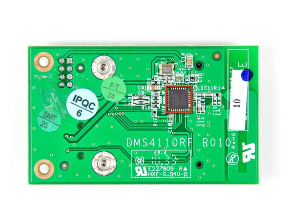

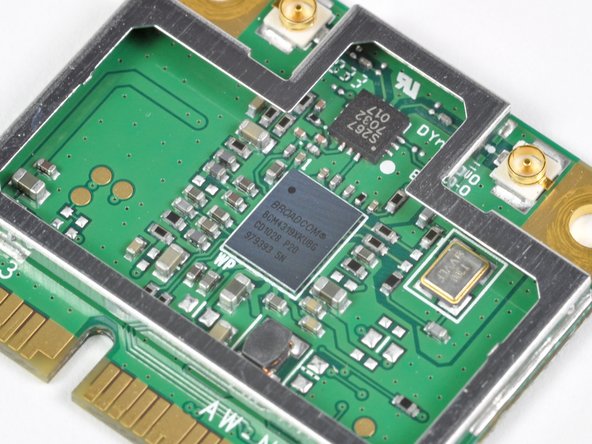

    • The wireless card assembly is composed of a Mini PCI-E wireless card and an interconnect board where the cable from the motherboard is connected.
    • On the back side of the interconnect board we found a Nordic Semiconductor NRF24LU1P transceiver.
    • This chip is most likely used to decode signals received from the awesome QWERTY wireless remote.
    • We recently found the same chip in the Boxee's direct competitor, the Logitech Revue.
    • The Mini PCI-E wireless card employs a Broadcom BCM4319XKUBG.
    • An remote control antenna is printed into the interconnect board right below the Mini PCI-E socket. This is positioned near the top of the device when it is assembled to aid in remote control reception.

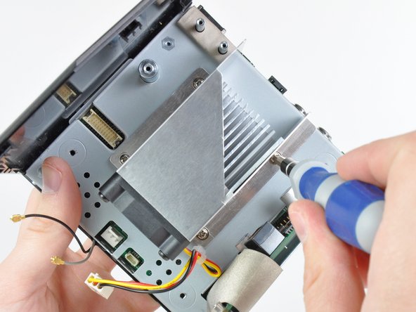

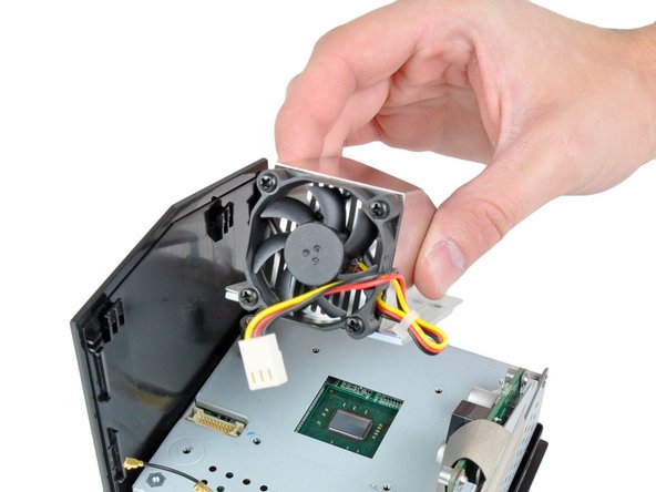

    • We progress by removing the fan and heatsink assembly from the CPU. It's time to find out what makes this baby tick.
    • Instead of using thermal paste, the Boxee Box uses a phase-change thermal pad much like the one found on the heat sink of the Logitech Revue.

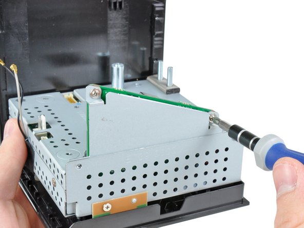

  11. Boxee Box Teardown: crwdns2935265:011crwdnd2935265:01crwdnd2935265:03crwdne2935265:0 Boxee Box Teardown: crwdns2935265:011crwdnd2935265:02crwdnd2935265:03crwdne2935265:0 Boxee Box Teardown: crwdns2935265:011crwdnd2935265:03crwdnd2935265:03crwdne2935265:0
    • A couple strips of EMI tape and a few more Phillips screws hold a very triangular power board in place.
    • The tape is most likely placed around the exposed circuits to eliminate audio interference from the power conversion process.

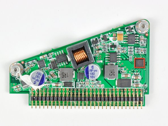

  12. Boxee Box Teardown: crwdns2935265:012crwdnd2935265:01crwdnd2935265:02crwdne2935265:0 Boxee Box Teardown: crwdns2935265:012crwdnd2935265:02crwdnd2935265:02crwdne2935265:0
    • What do you find inside of an oddly-shaped device? An oddly-shaped power board, of course.
    • On this board we find:
    • Texas Instruments TPS51116 DC/DC Controller
    • This board is most likely used to convert the 12V received from the power adapter into the voltages used by the motherboard and all the accessory boards.

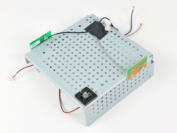

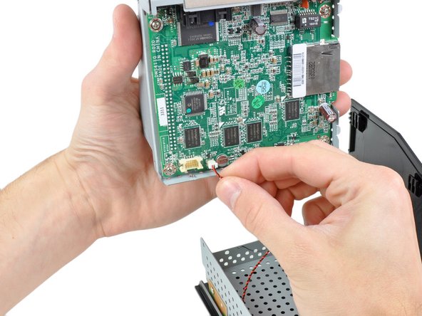

    • After removing a couple more Phillips screws, the motherboard can be removed from the rest of the metal frame.
    • Once it's lifted out, the power button connector is the only thing keeping us from getting a closer look at the board.
    • Once the motherboard is out, the bottom metal frame can be removed from the plastic outer casing.
    • The power button switch and dual antennas are mounted to the bottom metal frame, making it one compact unit.

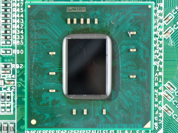

  14. Boxee Box Teardown: crwdns2935265:014crwdnd2935265:01crwdnd2935265:02crwdne2935265:0 Boxee Box Teardown: crwdns2935265:014crwdnd2935265:02crwdnd2935265:02crwdne2935265:0
    • After popping off the top metal cover, we find:
    • Intel Atom CE4110 SOC processor
    • Wolfson WM8524G stereo DAC
    • AKM 8137A multi-clock generator
    • Nanya 1035 NT5CB128MCN-CG 512 MB DDR3 SDRAM (1/2 total RAM capacity)
    • RealTek RTL8201N 10/100 Ethernet PHYceiver
    • FE1.1 USB 2.0 HUB LG3A924A6180

Spunkhart - crwdns2934203:0crwdne2934203:0
One of my capacitors in step 12 overheated and is leaking. This has broken my boxee, can anyone help me find the exact capacitor I should order?
Thank you,
Jamie
