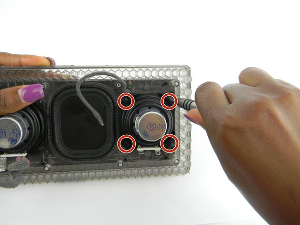

  6. Bowers and Wilkins T7 Speaker Driver Replacement, Speaker Driver: crwdns2935265:06crwdnd2935265:01crwdnd2935265:02crwdne2935265:0 Bowers and Wilkins T7 Speaker Driver Replacement, Speaker Driver: crwdns2935265:06crwdnd2935265:02crwdnd2935265:02crwdne2935265:0
    • Remove the 7mm screws around the speaker using a J100 Phillips head screwdriver.
    • There are 4 screws in total around each speaker.
  7. Bowers and Wilkins T7 Speaker Driver Replacement: crwdns2935265:07crwdnd2935265:01crwdnd2935265:01crwdne2935265:0
    • Now that all the screws are removed, pull straight up on the speaker drive to remove the speaker drive component.
