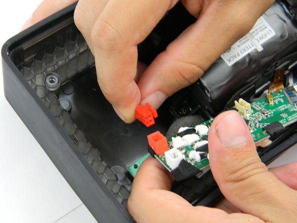

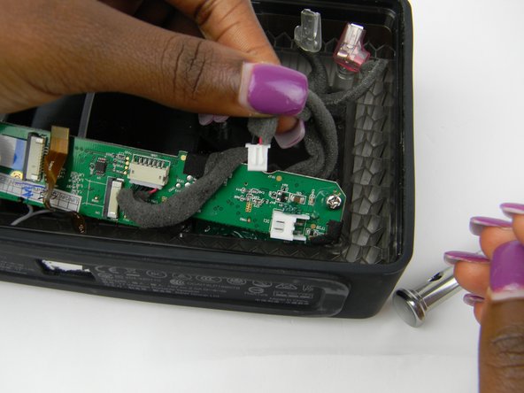

  5. Bowers and Wilkins T7 Motherboard Replacement: crwdns2935265:05crwdnd2935265:01crwdnd2935265:03crwdne2935265:0 Bowers and Wilkins T7 Motherboard Replacement: crwdns2935265:05crwdnd2935265:02crwdnd2935265:03crwdne2935265:0 Bowers and Wilkins T7 Motherboard Replacement: crwdns2935265:05crwdnd2935265:03crwdnd2935265:03crwdne2935265:0
    • Gently squeeze the internal locking mechanism inside the red and white terminals with either your fingers or a pair of precision tweezers.
    • While squeezing the internal locking mechanism, pull back the terminal.
    • Repeat this process for the second speaker.

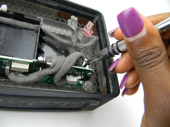

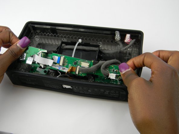

  6. Bowers and Wilkins T7 Motherboard Replacement, Motherboard: crwdns2935265:06crwdnd2935265:01crwdnd2935265:03crwdne2935265:0 Bowers and Wilkins T7 Motherboard Replacement, Motherboard: crwdns2935265:06crwdnd2935265:02crwdnd2935265:03crwdne2935265:0 Bowers and Wilkins T7 Motherboard Replacement, Motherboard: crwdns2935265:06crwdnd2935265:03crwdnd2935265:03crwdne2935265:0
    • Remove the leftmost 14mm screw with the J1 screwdriver tip.
    • Remove the rightmost 14mm screw with the J1 screwdriver tip.
    • With the screws removed, the motherboard is now loose.

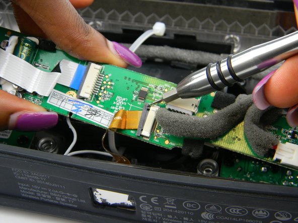

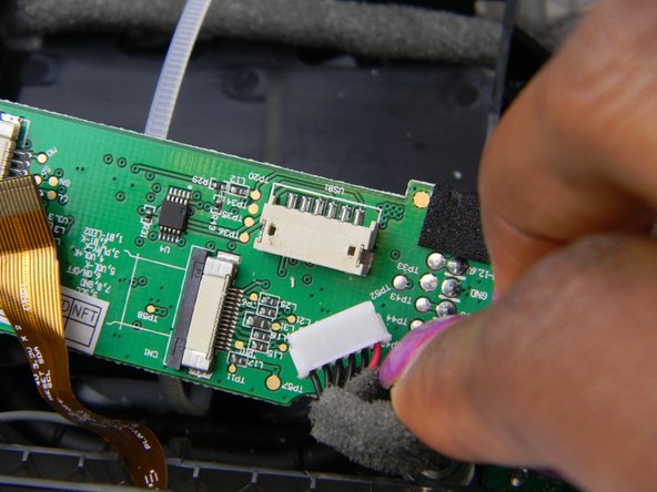

  7. Bowers and Wilkins T7 Motherboard Replacement: crwdns2935265:07crwdnd2935265:01crwdnd2935265:03crwdne2935265:0 Bowers and Wilkins T7 Motherboard Replacement: crwdns2935265:07crwdnd2935265:02crwdnd2935265:03crwdne2935265:0 Bowers and Wilkins T7 Motherboard Replacement: crwdns2935265:07crwdnd2935265:03crwdnd2935265:03crwdne2935265:0
    • Ensure you position your fingers, or a screwdriver tool with the 0.8 tip, in a position on the outside of the black tab.
    • It is advisable to use a nylon spudger to accomplish this task, because using a metal screwdriver like the one used in the image, can be unnecessarily dangerous around delicate connectors and the motherboard in general.
    • When working with electronics, it's important to choose a tool that's ESD-safe to avoid accidental damage.
    • Slide the black tab out so the cable is able to be removed.
    • At this point, the cable is removed.
    • These ports are difficult, as you need to simultaneously push the black tab while pulling the cable.

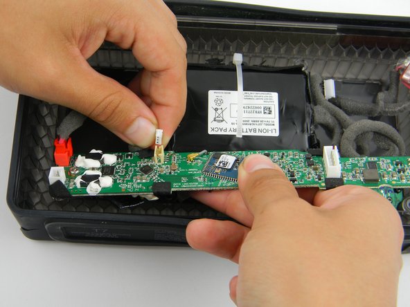

  11. Bowers and Wilkins T7 Motherboard Replacement: crwdns2935265:011crwdnd2935265:01crwdnd2935265:02crwdne2935265:0 Bowers and Wilkins T7 Motherboard Replacement: crwdns2935265:011crwdnd2935265:02crwdnd2935265:02crwdne2935265:0
    • Rotated the motherboard to access this cable.
    • Use your fingers to pull out the cable.

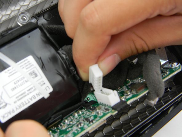

  12. Bowers and Wilkins T7 Motherboard Replacement: crwdns2935265:012crwdnd2935265:01crwdnd2935265:02crwdne2935265:0 Bowers and Wilkins T7 Motherboard Replacement: crwdns2935265:012crwdnd2935265:02crwdnd2935265:02crwdne2935265:0
    • The battery cable needs to be removed.
    • Use your fingers to pull the cable out of the port.

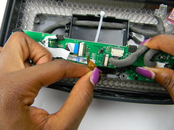

  14. Bowers and Wilkins T7 Motherboard Replacement: crwdns2935265:014crwdnd2935265:01crwdnd2935265:02crwdne2935265:0 Bowers and Wilkins T7 Motherboard Replacement: crwdns2935265:014crwdnd2935265:02crwdnd2935265:02crwdne2935265:0
    • Rotate the motherboard to access the last cable.
    • Pull on the gold connector to disconnect the cable.
