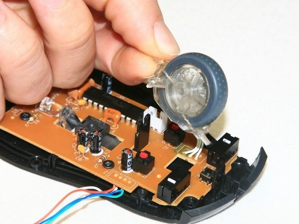

  10. Bottom Board Removal, Bottom Board: crwdns2935265:010crwdnd2935265:01crwdnd2935265:02crwdne2935265:0 Bottom Board Removal, Bottom Board: crwdns2935265:010crwdnd2935265:02crwdnd2935265:02crwdne2935265:0
    • Pop the scroll wheel out of the snap holding it in place. You can use your finger or a spudger to do so.
  11. Bottom Board Removal: crwdns2935265:011crwdnd2935265:01crwdnd2935265:02crwdne2935265:0 Bottom Board Removal: crwdns2935265:011crwdnd2935265:02crwdnd2935265:02crwdne2935265:0
    • Locate the four 5 mm black flat head screws on the corners of the bottom board.
    • Unscrew these four black screws.

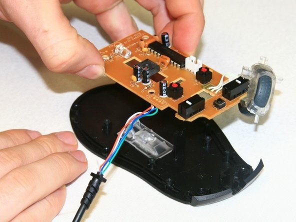

  12. Bottom Board Removal: crwdns2935265:012crwdnd2935265:01crwdnd2935265:03crwdne2935265:0 Bottom Board Removal: crwdns2935265:012crwdnd2935265:02crwdnd2935265:03crwdne2935265:0 Bottom Board Removal: crwdns2935265:012crwdnd2935265:03crwdnd2935265:03crwdne2935265:0
    • Lift the bottom board up to remove from its mounting posts. This will separate it completely from the bottom panel of the mouse.
