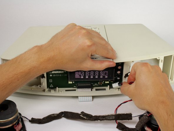

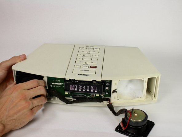

  8. Bose Wave Radio AWR1-1W Speaker Replacement: crwdns2935265:08crwdnd2935265:01crwdnd2935265:03crwdne2935265:0 Bose Wave Radio AWR1-1W Speaker Replacement: crwdns2935265:08crwdnd2935265:02crwdnd2935265:03crwdne2935265:0 Bose Wave Radio AWR1-1W Speaker Replacement: crwdns2935265:08crwdnd2935265:03crwdnd2935265:03crwdne2935265:0
    • Once the panel is released on the left side, wedge the spudger between the top panel and front grill of the device as shown.
    • Apply pressure and move the spudger upward until the front grill pops out.
    • Repeat for the right side of the device.
  9. Bose Wave Radio AWR1-1W Speaker Replacement: crwdns2935265:09crwdnd2935265:01crwdnd2935265:01crwdne2935265:0
    • Lift the front grill away from the device.

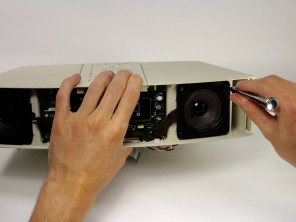

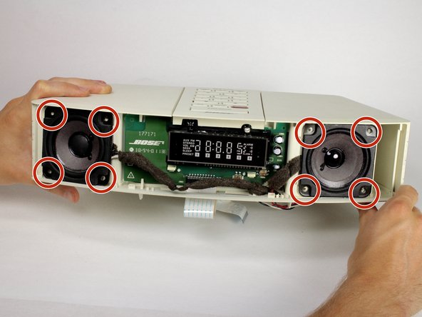

  10. Bose Wave Radio AWR1-1W Speaker Replacement, Speakers: crwdns2935265:010crwdnd2935265:01crwdnd2935265:03crwdne2935265:0 Bose Wave Radio AWR1-1W Speaker Replacement, Speakers: crwdns2935265:010crwdnd2935265:02crwdnd2935265:03crwdne2935265:0 Bose Wave Radio AWR1-1W Speaker Replacement, Speakers: crwdns2935265:010crwdnd2935265:03crwdnd2935265:03crwdne2935265:0
    • Remove a total of eight 15mm Phillips #2 screws surrounding each speaker.
  11. Bose Wave Radio AWR1-1W Speaker Replacement: crwdns2935265:011crwdnd2935265:01crwdnd2935265:03crwdne2935265:0 Bose Wave Radio AWR1-1W Speaker Replacement: crwdns2935265:011crwdnd2935265:02crwdnd2935265:03crwdne2935265:0 Bose Wave Radio AWR1-1W Speaker Replacement: crwdns2935265:011crwdnd2935265:03crwdnd2935265:03crwdne2935265:0
    • Gently pull each speaker out of the device.
  12. Bose Wave Radio AWR1-1W Speaker Replacement: crwdns2935265:012crwdnd2935265:01crwdnd2935265:03crwdne2935265:0 Bose Wave Radio AWR1-1W Speaker Replacement: crwdns2935265:012crwdnd2935265:02crwdnd2935265:03crwdne2935265:0 Bose Wave Radio AWR1-1W Speaker Replacement: crwdns2935265:012crwdnd2935265:03crwdnd2935265:03crwdne2935265:0
    • Pull the wire connected to the speakers out of the device.
    • You already disconnected this wire from the inside of the device earlier.
