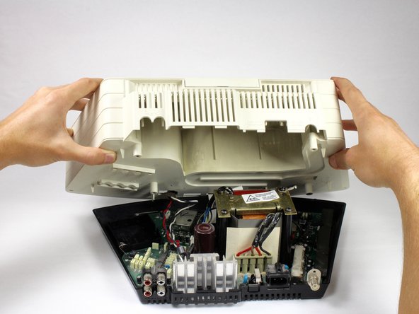

  3. Bose Wave Radio AWR1-1W Screen Replacement: crwdns2935265:03crwdnd2935265:01crwdnd2935265:03crwdne2935265:0 Bose Wave Radio AWR1-1W Screen Replacement: crwdns2935265:03crwdnd2935265:02crwdnd2935265:03crwdne2935265:0 Bose Wave Radio AWR1-1W Screen Replacement: crwdns2935265:03crwdnd2935265:03crwdnd2935265:03crwdne2935265:0
    • Gently lift the top off of the device.
    • Lift in the direction shown to avoid damaging the wires connecting the top and base of the device.

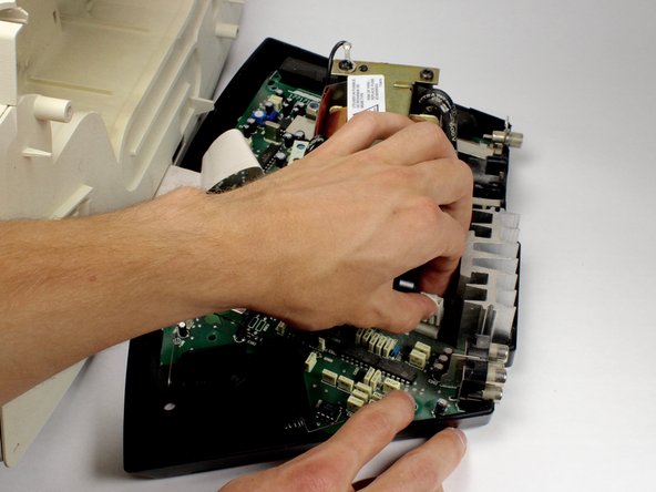

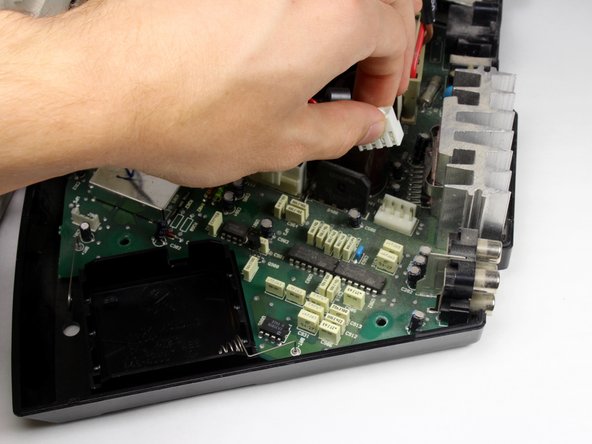

    • Pinch and unplug the white connector from the device.
  5. Bose Wave Radio AWR1-1W Screen Replacement: crwdns2935265:05crwdnd2935265:01crwdnd2935265:03crwdne2935265:0 Bose Wave Radio AWR1-1W Screen Replacement: crwdns2935265:05crwdnd2935265:02crwdnd2935265:03crwdne2935265:0 Bose Wave Radio AWR1-1W Screen Replacement: crwdns2935265:05crwdnd2935265:03crwdnd2935265:03crwdne2935265:0

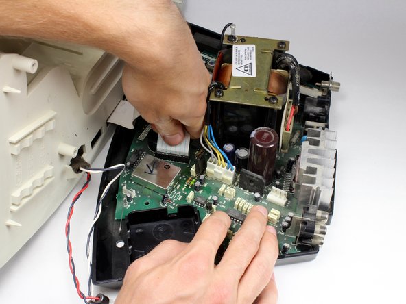

    • Gently pinch and pull on the white ribbon cable to disconnect it from the base.
  6. Bose Wave Radio AWR1-1W Screen Replacement: crwdns2935265:06crwdnd2935265:01crwdnd2935265:01crwdne2935265:0
    • The base should now be completely detached from the device.

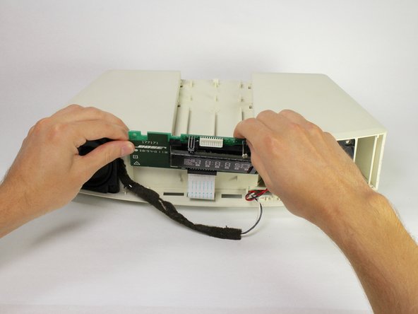

  11. Bose Wave Radio AWR1-1W Screen Replacement: crwdns2935265:011crwdnd2935265:01crwdnd2935265:01crwdne2935265:0
    • Move the spudger up until the button panel is loose.
    • Push forward on the back of the button panel to disconnect the panel from the top of the device.
  12. Bose Wave Radio AWR1-1W Screen Replacement: crwdns2935265:012crwdnd2935265:01crwdnd2935265:02crwdne2935265:0 Bose Wave Radio AWR1-1W Screen Replacement: crwdns2935265:012crwdnd2935265:02crwdnd2935265:02crwdne2935265:0

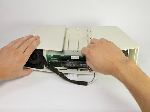

    • Turn the device around.
    • Pull the button panel forward with one hand and push the screen assembly into the device with the other to disconnect the button panel.

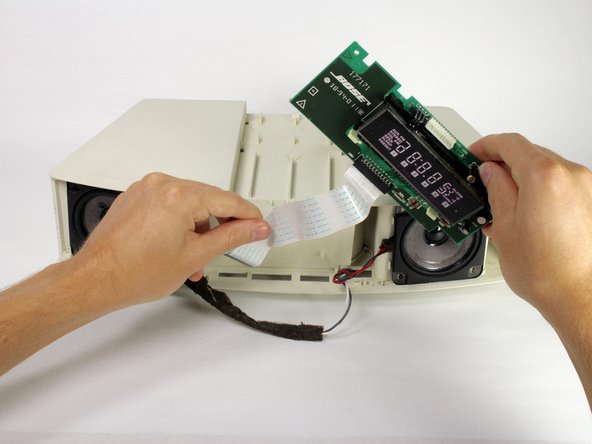

    • Gently pull the top of the screen assembly away from the device.
  14. Bose Wave Radio AWR1-1W Screen Replacement: crwdns2935265:014crwdnd2935265:01crwdnd2935265:02crwdne2935265:0 Bose Wave Radio AWR1-1W Screen Replacement: crwdns2935265:014crwdnd2935265:02crwdnd2935265:02crwdne2935265:0
    • Lift the screen assembly upward and pull the white wire strip out of the device.
