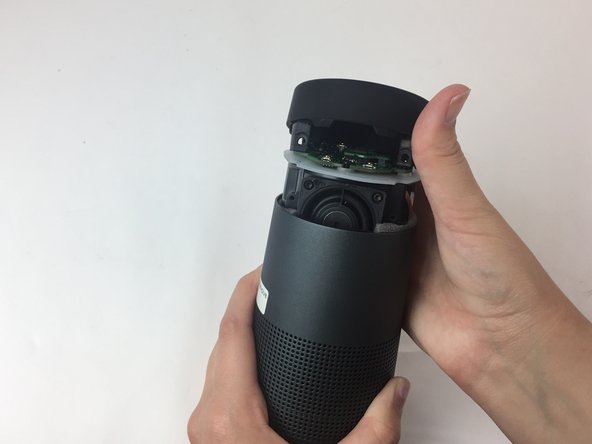

    • Using your hands, grip and separate the soft plastic and the metal casing away from each other with some small force.
  6. Bose Soundlink Revolve Top Circuit Board Replacement: crwdns2935265:06crwdnd2935265:01crwdnd2935265:01crwdne2935265:0
    • Remove the (4) four screws shown around the top of the inside.
    • (2) two of the screws are shown here, the other side will look the same.
  7. Bose Soundlink Revolve Top Circuit Board Replacement: crwdns2935265:07crwdnd2935265:01crwdnd2935265:02crwdne2935265:0 Bose Soundlink Revolve Top Circuit Board Replacement: crwdns2935265:07crwdnd2935265:02crwdnd2935265:02crwdne2935265:0
    • Pry up and remove the soft plastic casing from the rest of the device.

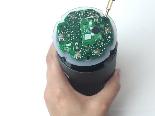

    • Remove the 3 screws holding down the top circuit board.
  9. Bose Soundlink Revolve Top Circuit Board Replacement: crwdns2935265:09crwdnd2935265:01crwdnd2935265:01crwdne2935265:0
    • Lift up and look on the underside of the circuit board.
    • Using the plastic opening tool, pry open the wide clamp keeping a ribbon to the top circuit board. The top circuit board can now freely be removed from the device.
