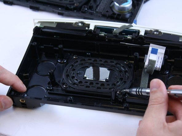

  9. Bose SoundTouch Portable Subwoofer Replacement, Subwoofer: crwdns2935265:09crwdnd2935265:01crwdnd2935265:02crwdne2935265:0 Bose SoundTouch Portable Subwoofer Replacement, Subwoofer: crwdns2935265:09crwdnd2935265:02crwdnd2935265:02crwdne2935265:0
    • Separate the case that holds the subwoofer in place.
    • Be careful when doing this step because there are several connectors inside.

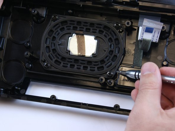

    • Gently pull on the connectors at the circuit board to remove. Remove the screws from the circuit board and set the board aside.
  11. Bose SoundTouch Portable Subwoofer Replacement: crwdns2935265:011crwdnd2935265:01crwdnd2935265:03crwdne2935265:0 Bose SoundTouch Portable Subwoofer Replacement: crwdns2935265:011crwdnd2935265:02crwdnd2935265:03crwdne2935265:0 Bose SoundTouch Portable Subwoofer Replacement: crwdns2935265:011crwdnd2935265:03crwdnd2935265:03crwdne2935265:0
    • Remove the four screws from the subwoofer and lift it out of the casing.
