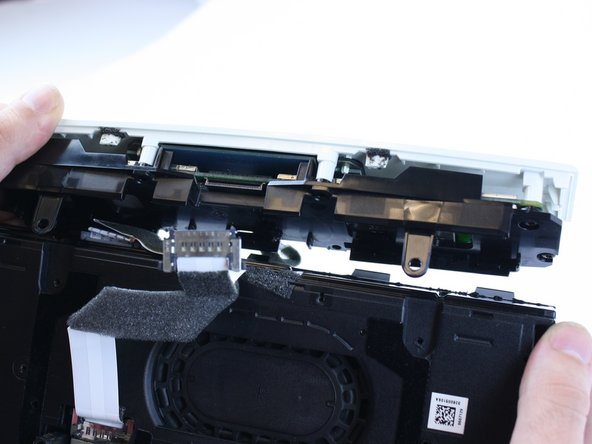

  7. Bose SoundTouch Portable Motherboard Replacement: crwdns2935265:07crwdnd2935265:01crwdnd2935265:03crwdne2935265:0 Bose SoundTouch Portable Motherboard Replacement: crwdns2935265:07crwdnd2935265:02crwdnd2935265:03crwdne2935265:0 Bose SoundTouch Portable Motherboard Replacement: crwdns2935265:07crwdnd2935265:03crwdnd2935265:03crwdne2935265:0
    • Pinch and remove the connectors.
    • Use a flat tool to pry off the top piece.

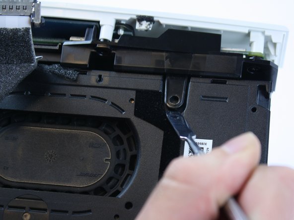

  8. Bose SoundTouch Portable Motherboard Replacement: crwdns2935265:08crwdnd2935265:01crwdnd2935265:03crwdne2935265:0 Bose SoundTouch Portable Motherboard Replacement: crwdns2935265:08crwdnd2935265:02crwdnd2935265:03crwdne2935265:0 Bose SoundTouch Portable Motherboard Replacement: crwdns2935265:08crwdnd2935265:03crwdnd2935265:03crwdne2935265:0
    • Remove the four T-10 Torx screws holding the plastic cover in place.
    • Remove the one T-10 Torx screw that is holding the motherboard in place.
    • Pry off the motherboard.
