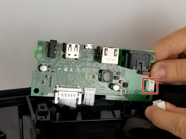

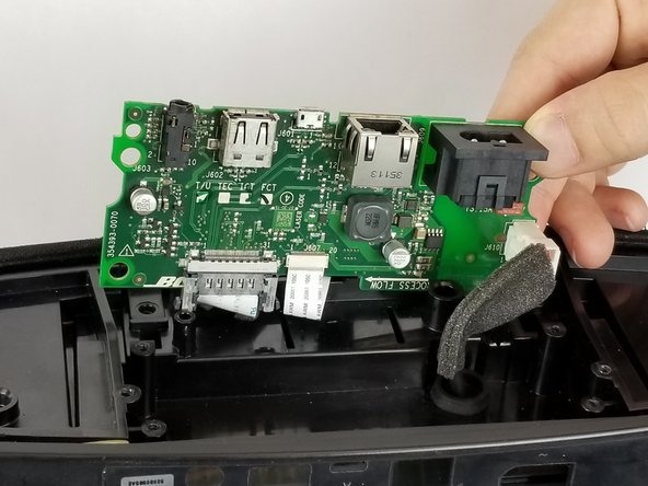

    3. Bose SoundTouch 20 Motherboard Replacement: crwdns2935265:03crwdnd2935265:01crwdnd2935265:02crwdne2935265:0 Bose SoundTouch 20 Motherboard Replacement: crwdns2935265:03crwdnd2935265:02crwdnd2935265:02crwdne2935265:0
      • Remove the (4) four 1.5 cm screws connecting the power board to the speaker.
      • Remove the (2) two 1 cm screws connecting the power board to the speaker.
      • Gently lift the board up.
      • When lifting the board, be careful of the two ribbons located underneath the board. Don't lift the board straight up, instead tilt it towards the cables. As shown in picture 2.
    4. Bose SoundTouch 20 Motherboard Replacement: crwdns2935265:04crwdnd2935265:01crwdnd2935265:02crwdne2935265:0 Bose SoundTouch 20 Motherboard Replacement: crwdns2935265:04crwdnd2935265:02crwdnd2935265:02crwdne2935265:0
      • Remove the white cable by pressing on the side of the connector with a tab and pulling backwards.
