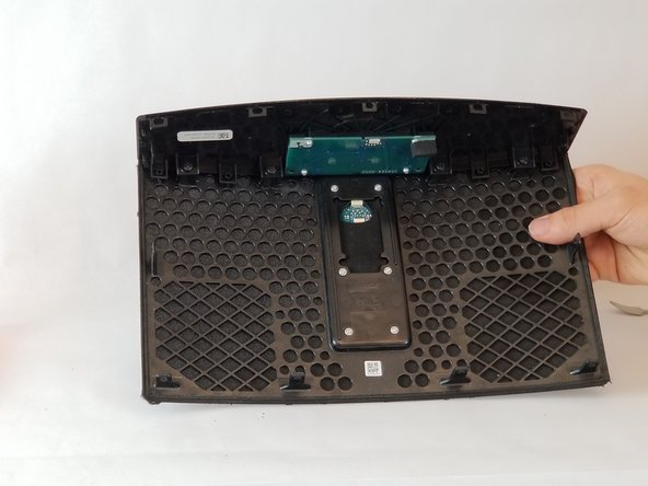

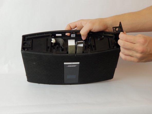

    7. Bose SoundTouch 20  Screen Replacement: crwdns2935265:07crwdnd2935265:01crwdnd2935265:03crwdne2935265:0 Bose SoundTouch 20  Screen Replacement: crwdns2935265:07crwdnd2935265:02crwdnd2935265:03crwdne2935265:0 Bose SoundTouch 20  Screen Replacement: crwdns2935265:07crwdnd2935265:03crwdnd2935265:03crwdne2935265:0
      • Remove the (2) two 1.5 cm screws circled in picture one.
      • Rotate the speaker to its side and remove the (2) two 1.5 cm screws circled in picture 2. Remove these screws on either side of the speaker.
      • After all screws are removed, gently remove the cover from the speaker as shown in picture 3.

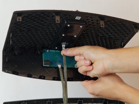

    8. Bose SoundTouch 20  Screen Replacement: crwdns2935265:08crwdnd2935265:01crwdnd2935265:03crwdne2935265:0 Bose SoundTouch 20  Screen Replacement: crwdns2935265:08crwdnd2935265:02crwdnd2935265:03crwdne2935265:0 Bose SoundTouch 20  Screen Replacement: crwdns2935265:08crwdnd2935265:03crwdnd2935265:03crwdne2935265:0
      • After lifting the cover, you will see two ribbons attaching the cover to the speaker. Gently remove these ribbons by pulling straight down.
      • Make sure to pull the ribbons straight out so you don't bend or damage the ribbon.
    9. Bose SoundTouch 20  Screen Replacement: crwdns2935265:09crwdnd2935265:01crwdnd2935265:02crwdne2935265:0 Bose SoundTouch 20  Screen Replacement: crwdns2935265:09crwdnd2935265:02crwdnd2935265:02crwdne2935265:0
      • Place the fully separated cover face down on a surface.
      • Using a star bit screwdriver, remove the (6) six screws circled in picture 1 to release the screen.
      • Gently push out the screen from the front of the cover.
