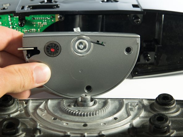

    • Use a T15 Torx screwdriver to remove the dock from the base. Be careful not to damage the ribbon during this step.
    • There is a torsion spring under the dock. When removed, this spring has a tendency to fly out. To avoid this, loosen the dock until it is able to move freely. Rotate it so that there is no tension in the spring. Then, you are free to undo the screw completely.

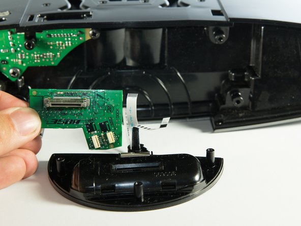

    • Remove the three 6mm T8 torques screws that hold the dock connector together and pull the top and bottom pieces apart.
    • There are some small parts that may fall out when the plastic pieces are separated. To minimize this, lay the piece with the dock connector facing down.
  7. Bose SoundDock Portable v2 Docking System Board Replacement: crwdns2935265:07crwdnd2935265:01crwdnd2935265:02crwdne2935265:0 Bose SoundDock Portable v2 Docking System Board Replacement: crwdns2935265:07crwdnd2935265:02crwdnd2935265:02crwdne2935265:0
    • Once the pieces are separated, the dock connector can be lifted out of the slot.
    • Using tweezers or your fingers, unplug the two ribbon connectors from the board.
