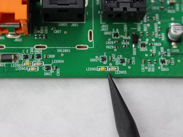

    • Locate on the back of the control panel where it states LED 902, 903, 904, and 905.
  8. Bose Solo 5 Sound Bar Indicator Light Replacement: crwdns2935265:08crwdnd2935265:01crwdnd2935265:02crwdne2935265:0 Bose Solo 5 Sound Bar Indicator Light Replacement: crwdns2935265:08crwdnd2935265:02crwdnd2935265:02crwdne2935265:0
    • If there is any debris located in these locations, use the spudger tool to thoroughly clean the area.
