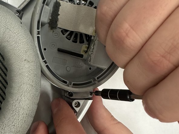

    • Remove the two 7-millimeter silver screws from the inside by using the Phillips #000 screwdriver to disconnect the back cover.

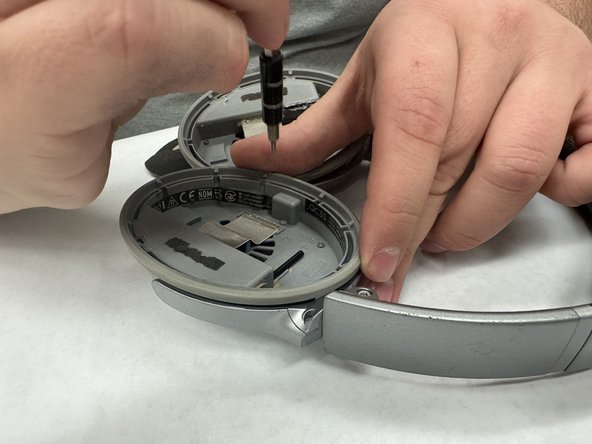

    • Remove the two 5-millimeter silver screws attaching the earphones to the headband using the Phillips #000 screwdriver.

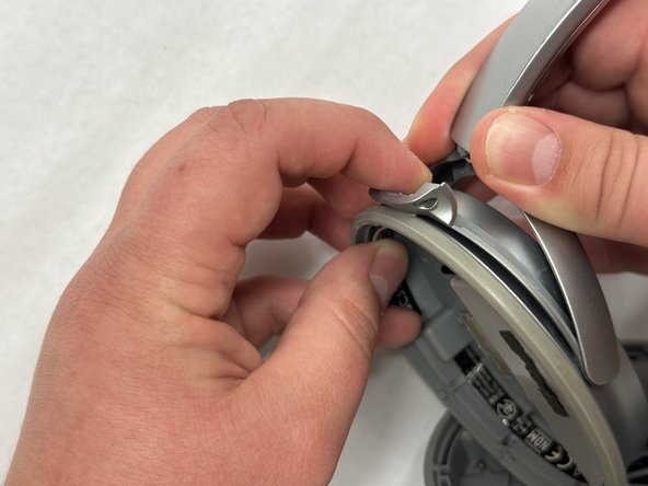

    • Insert the flat end of a metal spudger between the earpiece and the band joint.
    • Gently pry the joint outward until the earpiece slides free.
    • Note: A “metal spudger” is a flat, non-marring tool designed for leverage—use carefully to prevent damaging the plastic.

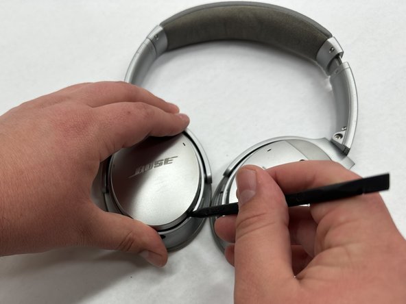

    • Detach the silver cover on the outside of the headset using the spudger.
    • Pry until you hear a distinct pop; this indicates the cover has separated from its base.

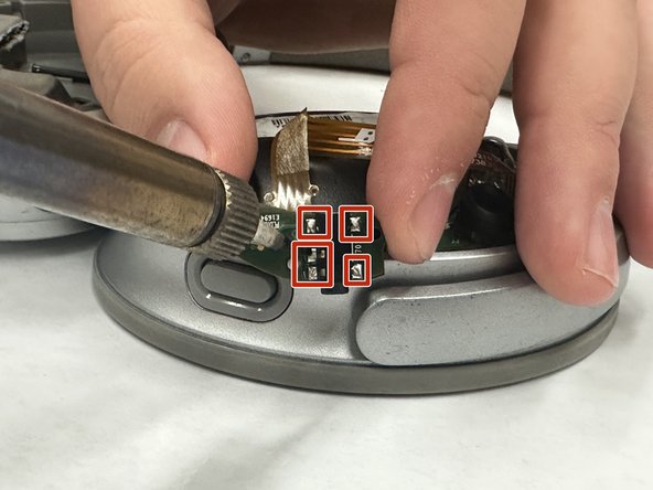

    • Warning: This step requires soldering skills and precision. If you’re not experienced with soldering, seek assistance.
    • Heat the solder joints near the cable connector port using a soldering iron.
    • Simultaneously apply solder wick to absorb the molten solder and release the ribbon cable.
    • Once solder is cleared, gently lift and remove the ribbon cable using tweezers—avoid pulling directly on the cable.
