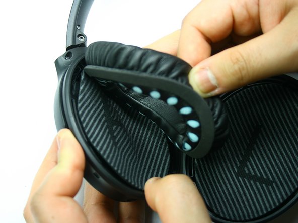

    • Firmly squeeze the torn portion of the ear cushion while grasping the plastic ear cup.
    • Pull the cushion toward the center and up to remove them from the fasteners.
    • Repeat this on all sides of the cushion until it's freed from the ear cup.
    • Repeat the above steps for the second ear cushion.

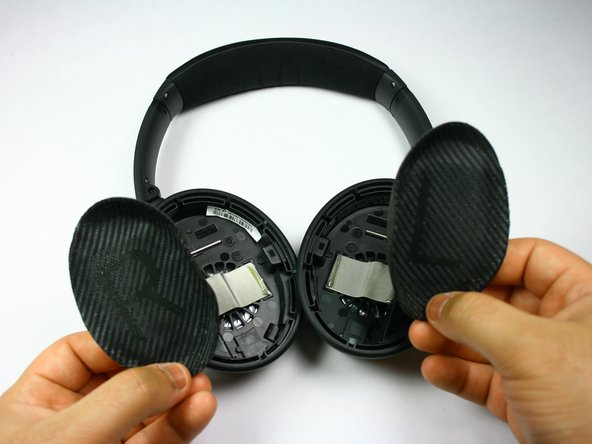

    • Take the top end of the scrim mat while firmly holding the plastic earcup.
    • Peel it back and away from the plastic to break the adhesive and remove it from the ear cup.
    • Repeat the above steps with the second scrim mat.
