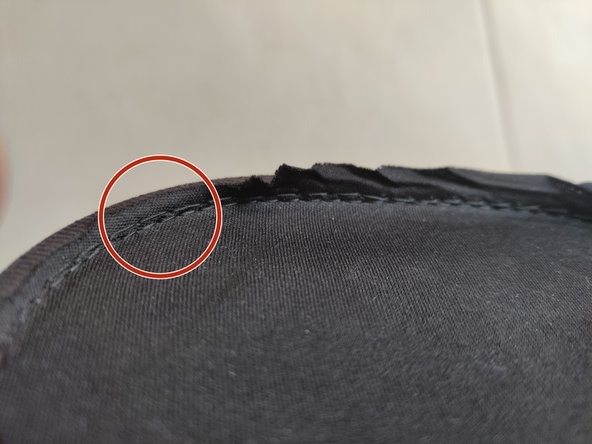

Bose QuietComfort 35 Case Zipper Replacement
  1. Bose QuietComfort 35 Case Zipper Replacement, Assess the damage: crwdns2935265:01crwdnd2935265:01crwdnd2935265:02crwdne2935265:0 Bose QuietComfort 35 Case Zipper Replacement, Assess the damage: crwdns2935265:01crwdnd2935265:02crwdnd2935265:02crwdne2935265:0

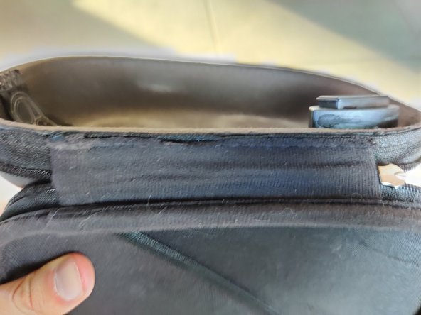

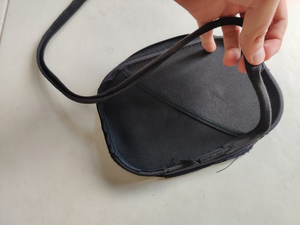

    • The zipper is damaged beyond repair, and needs to be completely replaced

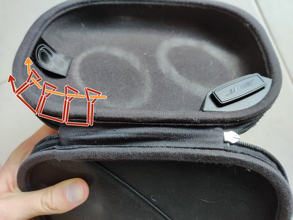

  2. Bose QuietComfort 35 Case Zipper Replacement, Open case: crwdns2935265:02crwdnd2935265:01crwdnd2935265:02crwdne2935265:0 Bose QuietComfort 35 Case Zipper Replacement, Open case: crwdns2935265:02crwdnd2935265:02crwdnd2935265:02crwdne2935265:0

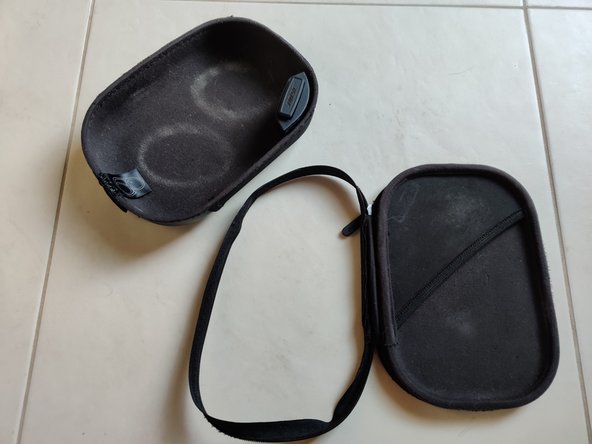

    • Open case
    • Remove accessories

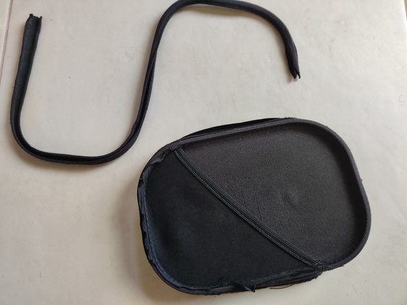

  3. Bose QuietComfort 35 Case Zipper Replacement, Exposing the seam: crwdns2935265:03crwdnd2935265:01crwdnd2935265:03crwdne2935265:0 Bose QuietComfort 35 Case Zipper Replacement, Exposing the seam: crwdns2935265:03crwdnd2935265:02crwdnd2935265:03crwdne2935265:0 Bose QuietComfort 35 Case Zipper Replacement, Exposing the seam: crwdns2935265:03crwdnd2935265:03crwdnd2935265:03crwdne2935265:0

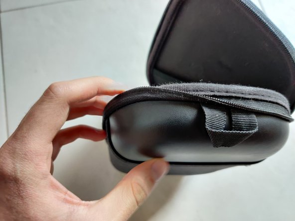

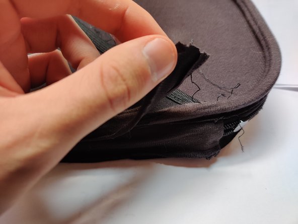

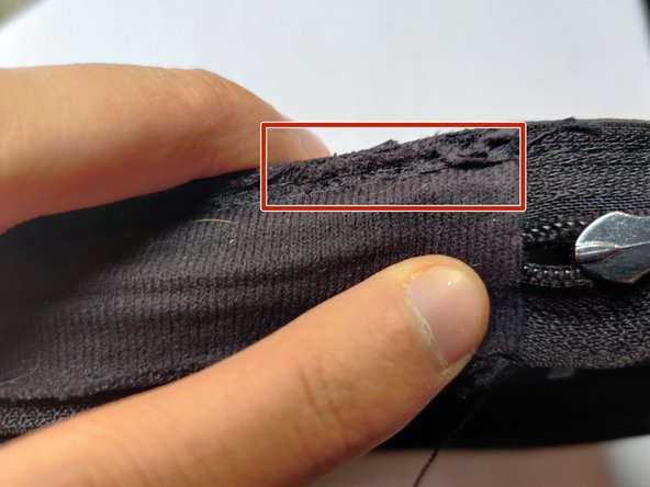

    • Take one side of the case and start close to the place where both sides of the case are joined
    • Push the fabric with the teeth out and down, exposing the seam
    • The fabric should sort of snap in place against the sides of the case
    • Work your way around this side of the case

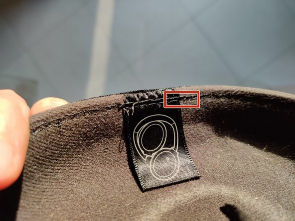

  4. Bose QuietComfort 35 Case Zipper Replacement, Exposing the seam: crwdns2935265:04crwdnd2935265:01crwdnd2935265:02crwdne2935265:0 Bose QuietComfort 35 Case Zipper Replacement, Exposing the seam: crwdns2935265:04crwdnd2935265:02crwdnd2935265:02crwdne2935265:0

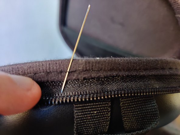

    • Repeat on the other half of the case

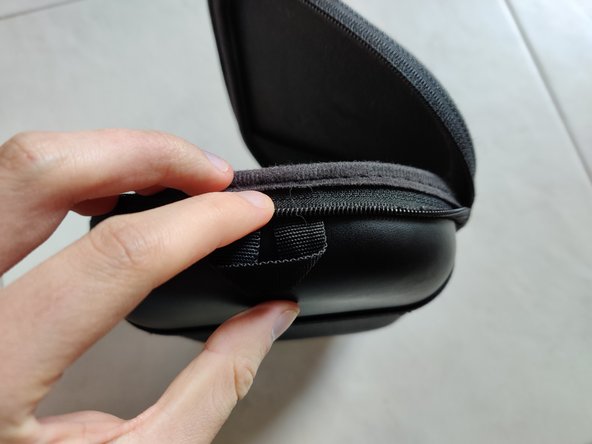

  5. Bose QuietComfort 35 Case Zipper Replacement, Sewing pattern: crwdns2935265:05crwdnd2935265:01crwdnd2935265:03crwdne2935265:0 Bose QuietComfort 35 Case Zipper Replacement, Sewing pattern: crwdns2935265:05crwdnd2935265:02crwdnd2935265:03crwdne2935265:0 Bose QuietComfort 35 Case Zipper Replacement, Sewing pattern: crwdns2935265:05crwdnd2935265:03crwdnd2935265:03crwdne2935265:0

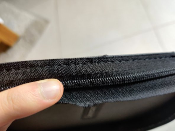

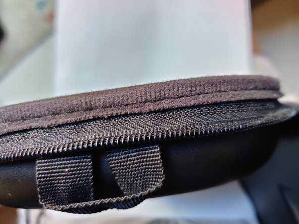

    • On each half, there is a soft piece of fabric that covers all the other seams and give the case a nice soft finish. The seam is visible on the outer part of the case, now that we pushed the teeth of the zipper down. It is held on by 2 threads
    • The first thread goes through the leather, makes a loop, and then goes back through the same hole. It then moves a few mm and repeats.
    • The second thread just goes through all the loops
    • Sew pattern schematic not to scale . It's just to get an idea of how the fabric is held on. The threads are pulled tight. They were most likely machine sewn

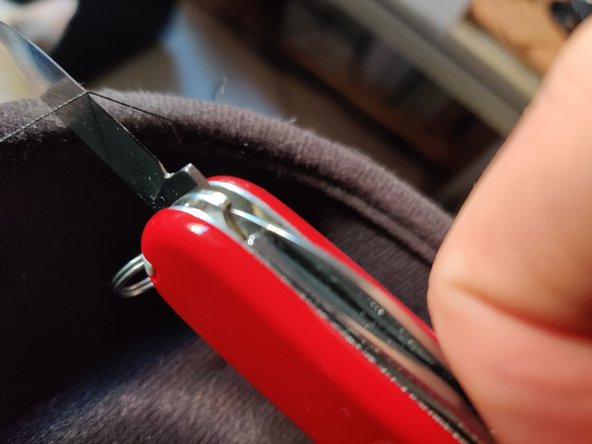

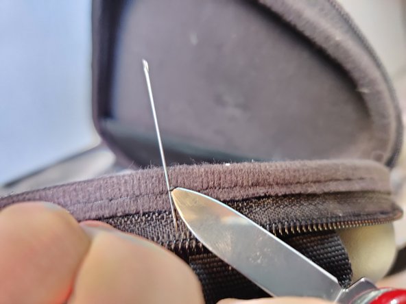

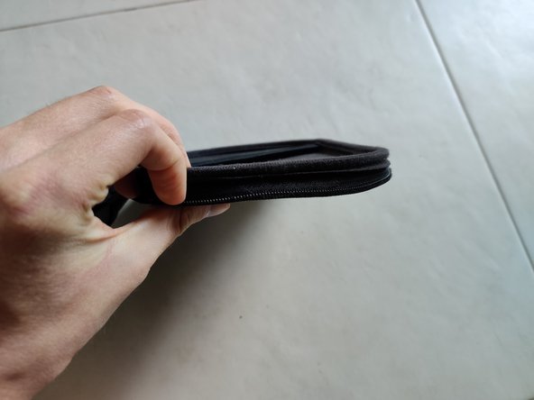

  6. Bose QuietComfort 35 Case Zipper Replacement, Cutting the thread: crwdns2935265:06crwdnd2935265:01crwdnd2935265:03crwdne2935265:0 Bose QuietComfort 35 Case Zipper Replacement, Cutting the thread: crwdns2935265:06crwdnd2935265:02crwdnd2935265:03crwdne2935265:0 Bose QuietComfort 35 Case Zipper Replacement, Cutting the thread: crwdns2935265:06crwdnd2935265:03crwdnd2935265:03crwdne2935265:0

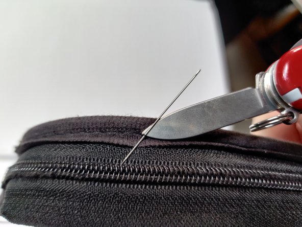

    • Start anywhere where you have a good visibility and access to the outer thread
    • Take a needle and work it behind the thread, to create some space
    • Insert the tip of a pair of scissors or the blade of a knife into the space and cut the thread

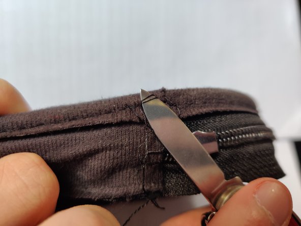

  7. Bose QuietComfort 35 Case Zipper Replacement, Start pulling out the thread: crwdns2935265:07crwdnd2935265:01crwdnd2935265:01crwdne2935265:0
    • Moving to the next neighbouring stitch, use a pointy item to pull the thread out
    • I found that the cork screw tool of a swiss army knife worked well, as the point is a bit dull, thus not getting stuck if the fabric, but still pointy enough to work it behind the thread, allowing me to work faster. The shape of the cork screw opener also naturally helps to pull the thread out

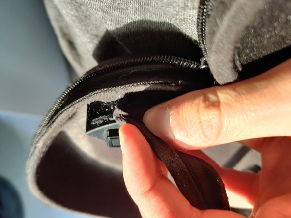

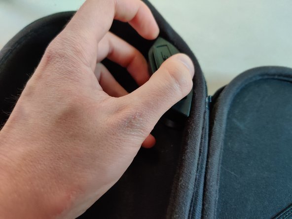

  10. Bose QuietComfort 35 Case Zipper Replacement, Dealing with the airplane jack: crwdns2935265:010crwdnd2935265:01crwdnd2935265:03crwdne2935265:0 Bose QuietComfort 35 Case Zipper Replacement, Dealing with the airplane jack: crwdns2935265:010crwdnd2935265:02crwdnd2935265:03crwdne2935265:0 Bose QuietComfort 35 Case Zipper Replacement, Dealing with the airplane jack: crwdns2935265:010crwdnd2935265:03crwdnd2935265:03crwdne2935265:0

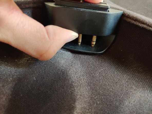

    • Once you get to the airplane adapter, you will encounter a problem
    • The airplane adapter socket is glued to the inner lining
    • You either remove it or you can just pull it away from the side of the case enough to work behind it. This requires a bit of force to remove the top layer of glue
    • If you remove the socket completely, be carful not to rip the lining. You made need some heat or chemical to dissolve the glue
  11. Bose QuietComfort 35 Case Zipper Replacement: crwdns2935265:011crwdnd2935265:01crwdnd2935265:03crwdne2935265:0 Bose QuietComfort 35 Case Zipper Replacement: crwdns2935265:011crwdnd2935265:02crwdnd2935265:03crwdne2935265:0 Bose QuietComfort 35 Case Zipper Replacement: crwdns2935265:011crwdnd2935265:03crwdnd2935265:03crwdne2935265:0
    • Remove the remaining stitches and peel off the fabric from the back of the socket

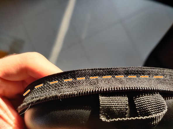

    • The zipper tape is still held to the case by one thread
    • Cut it and work your way around the case, the same way as for the first fabric, to undo the seam
    • On the inside there are 2 seams: one that holds the tape to the leather, and one that holds the outer fabric (the sort of "back pocket" of the case) to the leather. To avoid mistakes, undo the seam from the exterior of the case (orange stitches)

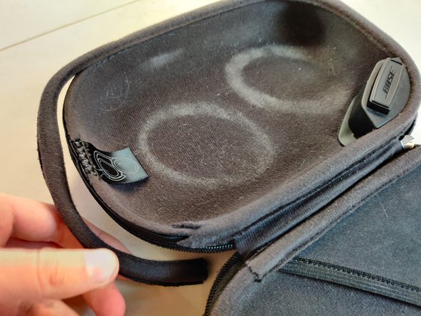

    • Once the thread has been removed all around, pull the soft concealer fabric off
  18. Bose QuietComfort 35 Case Zipper Replacement: crwdns2935265:018crwdnd2935265:01crwdnd2935265:03crwdne2935265:0 Bose QuietComfort 35 Case Zipper Replacement: crwdns2935265:018crwdnd2935265:02crwdnd2935265:03crwdne2935265:0 Bose QuietComfort 35 Case Zipper Replacement: crwdns2935265:018crwdnd2935265:03crwdnd2935265:03crwdne2935265:0
    • The tape is still held on, like for the other half, by a single thread.
    • On the inner bottom section of this half, there are 2 seams. One is to hold the inner pocket, which we don't need to remove. So as before, undo the seam from the outside.
