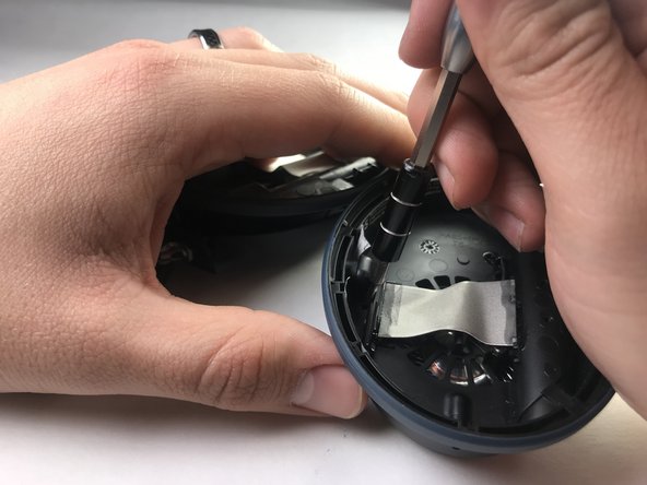

    • Once the soft lining is removed from behind the ear cushion, two screws will be exposed.
    • Carefully remove the two 5 mm screws with a precision screwdriver (PH00) and put aside.
