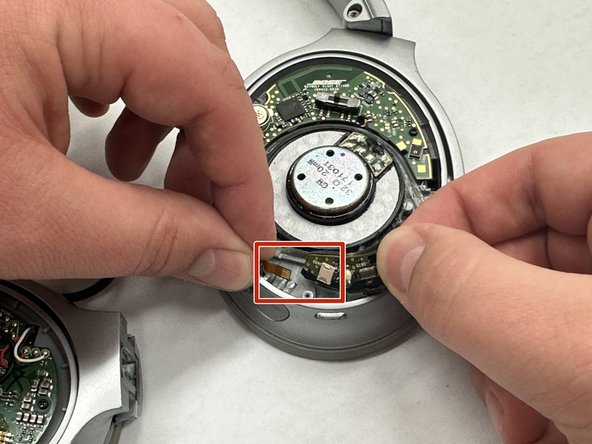

  10. Bose Quiet Comfort 35 II Speaker Driver Replacement: crwdns2935265:010crwdnd2935265:01crwdnd2935265:03crwdne2935265:0 Bose Quiet Comfort 35 II Speaker Driver Replacement: crwdns2935265:010crwdnd2935265:02crwdnd2935265:03crwdne2935265:0 Bose Quiet Comfort 35 II Speaker Driver Replacement: crwdns2935265:010crwdnd2935265:03crwdnd2935265:03crwdne2935265:0
    • Detach the second ribbon wire for the charging cable with your hands by pulling each side of the component to separate it.
    • No extra tools are needed.

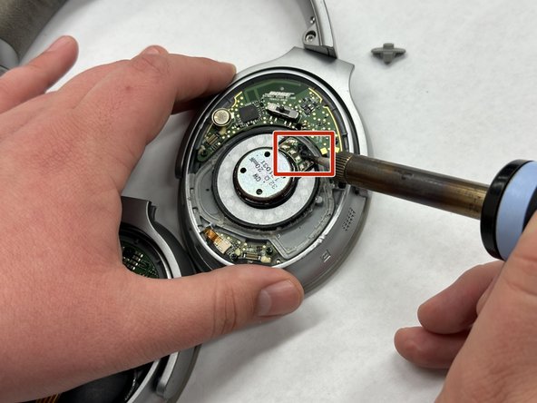

  13. Bose Quiet Comfort 35 II Speaker Driver Replacement: crwdns2935265:013crwdnd2935265:01crwdnd2935265:02crwdne2935265:0 Bose Quiet Comfort 35 II Speaker Driver Replacement: crwdns2935265:013crwdnd2935265:02crwdnd2935265:02crwdne2935265:0
    • De-solder the two speaker wires off of their post.
    • Prior knowledge is needed for this step, it can be very hazardous.
    • You can now reach the speaker driver and replace it with a new part.
