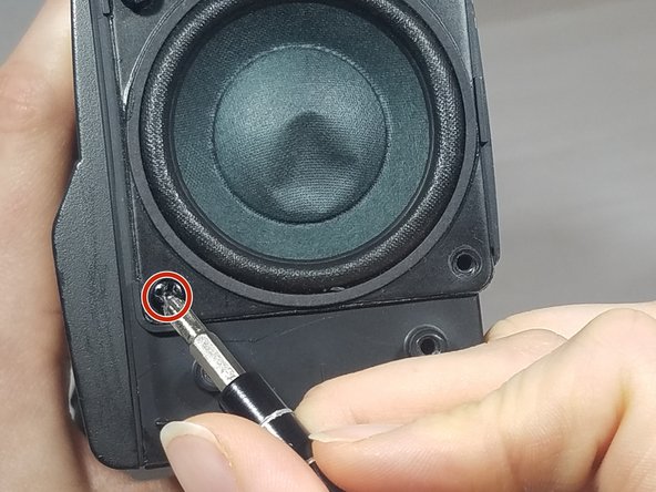

  5. Bose Cinemate 10 Subwoofer Replacement, Subwoofer: crwdns2935265:05crwdnd2935265:01crwdnd2935265:02crwdne2935265:0 Bose Cinemate 10 Subwoofer Replacement, Subwoofer: crwdns2935265:05crwdnd2935265:02crwdnd2935265:02crwdne2935265:0
    • Remove the 4, PH1, 10 mm screws from the subwoofer frame.

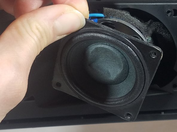

  6. Bose Cinemate 10 Subwoofer Replacement: crwdns2935265:06crwdnd2935265:01crwdnd2935265:02crwdne2935265:0 Bose Cinemate 10 Subwoofer Replacement: crwdns2935265:06crwdnd2935265:02crwdnd2935265:02crwdne2935265:0
    • Using the blue plastic opening tool, pry up on the edge of the subwoofer frame.
    • Using your fingers, lift up on the subwoofer frame until it separates completely from the main body of the device.

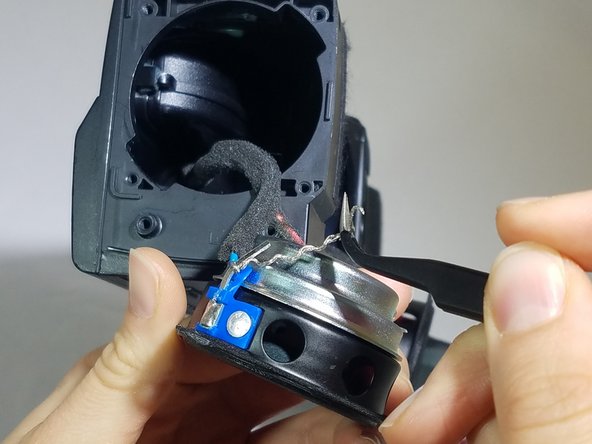

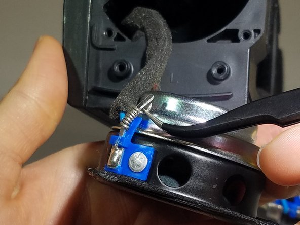

  7. Bose Cinemate 10 Subwoofer Replacement: crwdns2935265:07crwdnd2935265:01crwdnd2935265:03crwdne2935265:0 Bose Cinemate 10 Subwoofer Replacement: crwdns2935265:07crwdnd2935265:02crwdnd2935265:03crwdne2935265:0 Bose Cinemate 10 Subwoofer Replacement: crwdns2935265:07crwdnd2935265:03crwdnd2935265:03crwdne2935265:0
    • Using the curved precision tweezers, grasp end of wire.
    • Using the curved precision tweezers, unravel wire around blue metal post.
  8. Bose Cinemate 10 Subwoofer Replacement: crwdns2935265:08crwdnd2935265:01crwdnd2935265:02crwdne2935265:0 Bose Cinemate 10 Subwoofer Replacement: crwdns2935265:08crwdnd2935265:02crwdnd2935265:02crwdne2935265:0
    • After wire is completely unraveled, repeat steps 4 and 5, on red metal post.
    • Remove the speaker from the device.
