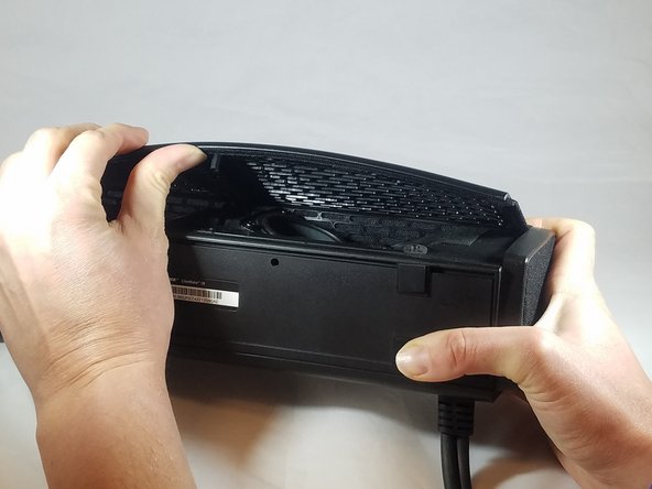

    • Orient the Bose Cinemate 10 so that the Bose Label is facing frontward.
    • Rotate the speaker so that the botton barcode is visible.
  2. Bose Cinemate 10 Speaker Grill Cover Replacement: crwdns2935265:02crwdnd2935265:01crwdnd2935265:03crwdne2935265:0 Bose Cinemate 10 Speaker Grill Cover Replacement: crwdns2935265:02crwdnd2935265:02crwdnd2935265:03crwdne2935265:0 Bose Cinemate 10 Speaker Grill Cover Replacement: crwdns2935265:02crwdnd2935265:03crwdnd2935265:03crwdne2935265:0
    • Insert the blue plastic opening tool into the crevice directly beneath the Bose Logo.
    • Using the blue plastic opening tool, pry upwards.
    • Work the blue plastic opening tool along edge of the speaker towards the right end of the speaker prying along the way
    • Move the blue plastic opening tool back to center, and then work the plastic opening tool towards the left end of the speaker, prying along the way
  3. Bose Cinemate 10 Speaker Grill Cover Replacement: crwdns2935265:03crwdnd2935265:01crwdnd2935265:03crwdne2935265:0 Bose Cinemate 10 Speaker Grill Cover Replacement: crwdns2935265:03crwdnd2935265:02crwdnd2935265:03crwdne2935265:0 Bose Cinemate 10 Speaker Grill Cover Replacement: crwdns2935265:03crwdnd2935265:03crwdnd2935265:03crwdne2935265:0

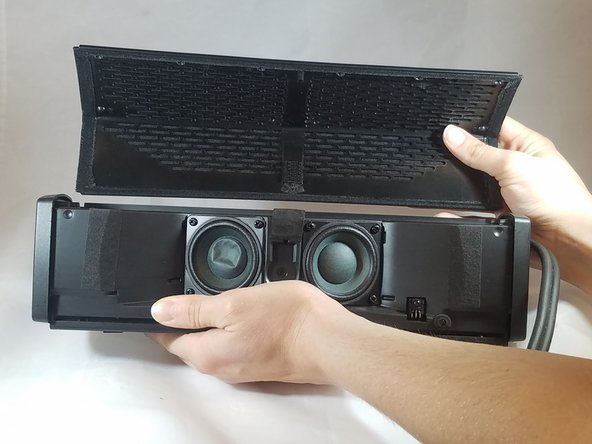

    • Insert fingers into crevice between the grill cover and device base and forcefully pry upwards.
    • Continue prying until the Speaker Grill cover is completly detached.
