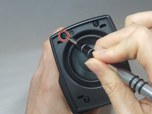

    • Using the blue plastic opening tool, pry up on the cloth covered end panel. The edge of end cap cover should separate from main body of device.
  2. Bose Cinemate 10 End Cap Replacement: crwdns2935265:02crwdnd2935265:01crwdnd2935265:01crwdne2935265:0
    • Using your fingers, lift up on the end cap cover until it separates completely from the main body of the device.
  3. Bose Cinemate 10 End Cap Replacement: crwdns2935265:03crwdnd2935265:01crwdnd2935265:02crwdne2935265:0 Bose Cinemate 10 End Cap Replacement: crwdns2935265:03crwdnd2935265:02crwdnd2935265:02crwdne2935265:0
    • Remove the 4, PH1, 15mm screws on the side speaker cover frame.
  4. Bose Cinemate 10 End Cap Replacement: crwdns2935265:04crwdnd2935265:01crwdnd2935265:01crwdne2935265:0
    • Remove speaker cover frame from main body of device.
