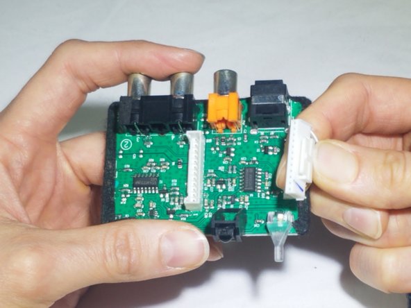

    • Locate the cable input port, on the back of the device.
    • Remove the 2, PH1, 15mm screws.
  2. Bose Cinemate 10 Circuit Board Replacement: crwdns2935265:02crwdnd2935265:01crwdnd2935265:03crwdne2935265:0 Bose Cinemate 10 Circuit Board Replacement: crwdns2935265:02crwdnd2935265:02crwdnd2935265:03crwdne2935265:0 Bose Cinemate 10 Circuit Board Replacement: crwdns2935265:02crwdnd2935265:03crwdnd2935265:03crwdne2935265:0
    • Gently, pull the base of the A/V cable directly outward, away from the main body of the device.
    • Slide the plastic cover to the right, which should free the cover from the main body of the device.
  3. Bose Cinemate 10 Circuit Board Replacement: crwdns2935265:03crwdnd2935265:01crwdnd2935265:03crwdne2935265:0 Bose Cinemate 10 Circuit Board Replacement: crwdns2935265:03crwdnd2935265:02crwdnd2935265:03crwdne2935265:0 Bose Cinemate 10 Circuit Board Replacement: crwdns2935265:03crwdnd2935265:03crwdnd2935265:03crwdne2935265:0
    • Using your fingers, gently pull outward on the multi-colored wire bundle until the black plastic wire harness is visible.
    • Press on the latch on the black plastic wire harness, and pull the multi-colored wire bundle simultaneously. The cables should now be detached from the harness.
  4. Bose Cinemate 10 Circuit Board Replacement: crwdns2935265:04crwdnd2935265:01crwdnd2935265:03crwdne2935265:0 Bose Cinemate 10 Circuit Board Replacement: crwdns2935265:04crwdnd2935265:02crwdnd2935265:03crwdne2935265:0 Bose Cinemate 10 Circuit Board Replacement: crwdns2935265:04crwdnd2935265:03crwdnd2935265:03crwdne2935265:0
    • Using your fingers, grasp the edges of cable input port.
    • Gently pull the cable input port away from main body of device. The Circuit Board should now be completely separated from the main body of the device.
  5. Bose Cinemate 10 Circuit Board Replacement: crwdns2935265:05crwdnd2935265:01crwdnd2935265:03crwdne2935265:0 Bose Cinemate 10 Circuit Board Replacement: crwdns2935265:05crwdnd2935265:02crwdnd2935265:03crwdne2935265:0 Bose Cinemate 10 Circuit Board Replacement: crwdns2935265:05crwdnd2935265:03crwdnd2935265:03crwdne2935265:0
    • Press the tab on side of white plastic cable harness, and pull gently on the multi-colored wire bundle simultaneously. The cable should completely detach from the Circuit Board.
