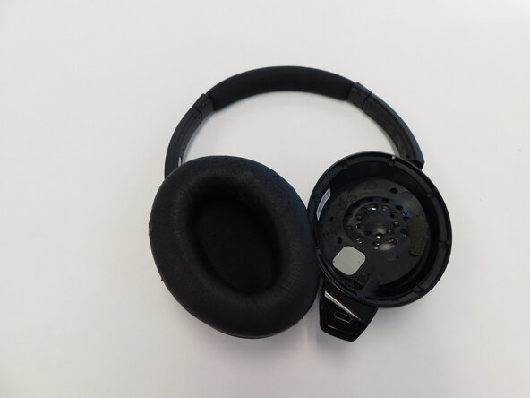

    • Carefully pull the cushions away from the sides of the headphones, sliding the cushions out from under the notches.

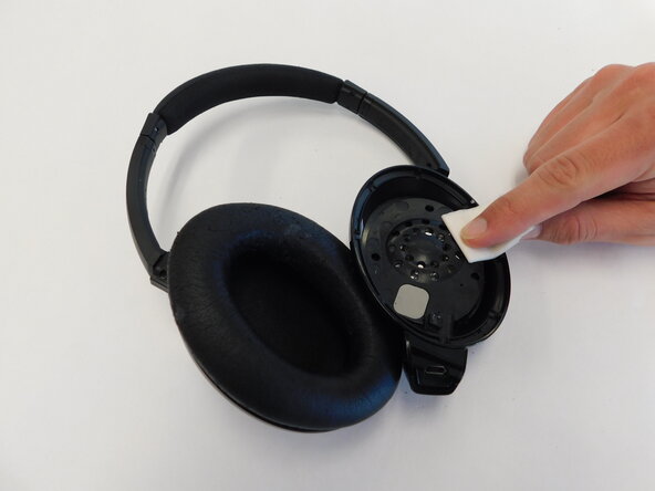

  2. Bose Ae2w Speaker Mesh Replacement: crwdns2935265:02crwdnd2935265:01crwdnd2935265:01crwdne2935265:0
    • Carefully wipe the inside of the earpiece clean. This can be done with a moistened cotton swab or alcohol wipes.
