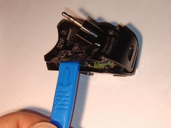

    • Remove the five screws on the module using a small tri-wing bit and a Phillips head bit.
    • Using an opening tool, gently pry the cover from the sides and open the module.

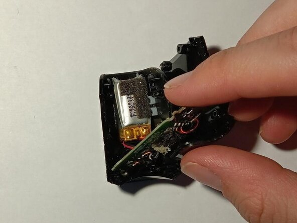

    • Gently lift the PCB to reveal the battery.
    • There may be a small piece of tape holding the PCB down that will need to be removed.
  4. Bose Ae2w Bluetooth Module Battery Replacement: crwdns2935265:04crwdnd2935265:01crwdnd2935265:02crwdne2935265:0 Bose Ae2w Bluetooth Module Battery Replacement: crwdns2935265:04crwdnd2935265:02crwdnd2935265:02crwdne2935265:0
    • The battery is secured with adhesive to the back of the module. Using the opening tool, gently pry off the battery.
    • Take care not to puncture the battery as you pry it off.

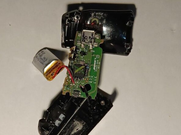

  5. Bose Ae2w Bluetooth Module Battery Replacement: crwdns2935265:05crwdnd2935265:01crwdnd2935265:01crwdne2935265:0
    • Carefully desolder the two battery wires from the PCB.
