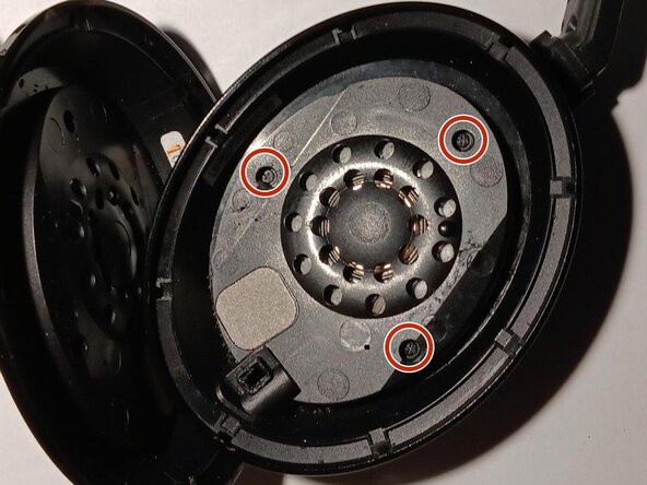

  7. Bose Ae2w 2.5 Audio Jack Replacement, 2.5 Audio Jack: crwdns2935265:07crwdnd2935265:01crwdnd2935265:02crwdne2935265:0 Bose Ae2w 2.5 Audio Jack Replacement, 2.5 Audio Jack: crwdns2935265:07crwdnd2935265:02crwdnd2935265:02crwdne2935265:0
    • Once the cushion and mesh are removed, remove the three screws in the earpiece.
  8. Bose Ae2w 2.5 Audio Jack Replacement: crwdns2935265:08crwdnd2935265:01crwdnd2935265:02crwdne2935265:0 Bose Ae2w 2.5 Audio Jack Replacement: crwdns2935265:08crwdnd2935265:02crwdnd2935265:02crwdne2935265:0
    • Gently separate the earpiece to access the audio jack.
    • Remove the two screws holding it in place.
    • Lift and remove the audio jack assembly.

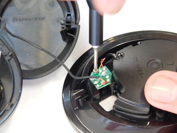

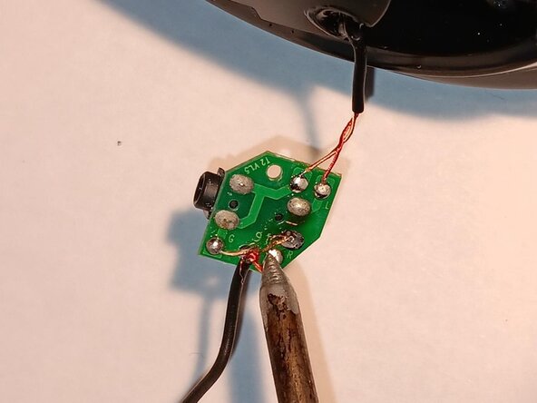

  9. Bose Ae2w 2.5 Audio Jack Replacement: crwdns2935265:09crwdnd2935265:01crwdnd2935265:02crwdne2935265:0 Bose Ae2w 2.5 Audio Jack Replacement: crwdns2935265:09crwdnd2935265:02crwdnd2935265:02crwdne2935265:0
    • Identify all solder connections on the audio jack circuit board.
    • Using your soldering iron, carefully desolder each wire from the circuit board.
    • Take care not to damage any of the wires, as they must be soldered onto the new replacement audio jack circuit board.
