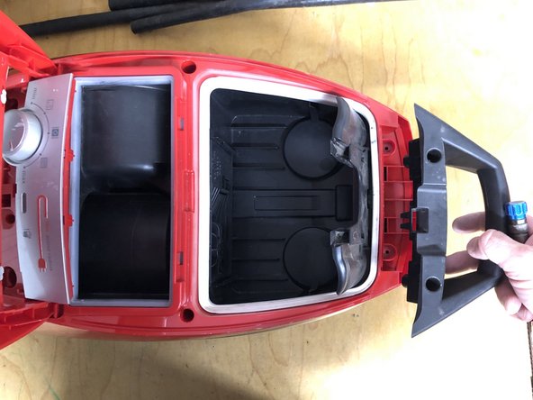

  4. Bosch Pro Animal BSGL5ZOO2 Teardown, Remove screws: crwdns2935265:04crwdnd2935265:01crwdnd2935265:02crwdne2935265:0 Bosch Pro Animal BSGL5ZOO2 Teardown, Remove screws: crwdns2935265:04crwdnd2935265:02crwdnd2935265:02crwdne2935265:0
    • Loosen the 6 screws with the screwdriver.
    • Remove front grip.

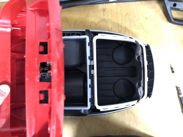

  5. Bosch Pro Animal BSGL5ZOO2 Teardown, Remove top side of housing: crwdns2935265:05crwdnd2935265:01crwdnd2935265:02crwdne2935265:0 Bosch Pro Animal BSGL5ZOO2 Teardown, Remove top side of housing: crwdns2935265:05crwdnd2935265:02crwdnd2935265:02crwdne2935265:0
    • Lift the top of the housing from the handle side
    • Remove the top of the housing towards the rear.

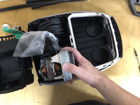

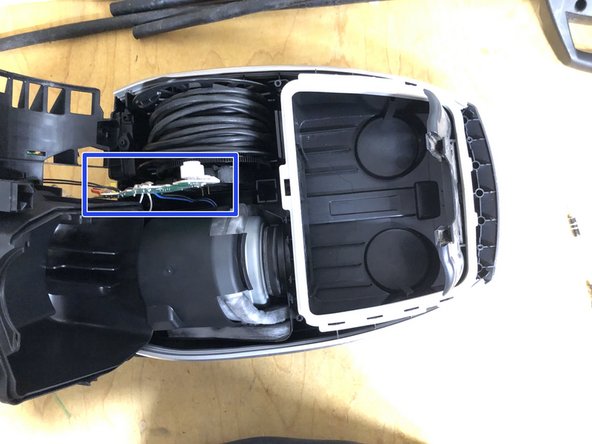

  6. Bosch Pro Animal BSGL5ZOO2 Teardown, Remove motor cover: crwdns2935265:06crwdnd2935265:01crwdnd2935265:03crwdne2935265:0 Bosch Pro Animal BSGL5ZOO2 Teardown, Remove motor cover: crwdns2935265:06crwdnd2935265:02crwdnd2935265:03crwdne2935265:0 Bosch Pro Animal BSGL5ZOO2 Teardown, Remove motor cover: crwdns2935265:06crwdnd2935265:03crwdnd2935265:03crwdne2935265:0
    • Remove motor cover towards the back.
    • Carefully remove the circuit board from the guides of the cable drum.
    • The motor is now accessible.
Repeat the steps in reverse order to reassemble your device.
