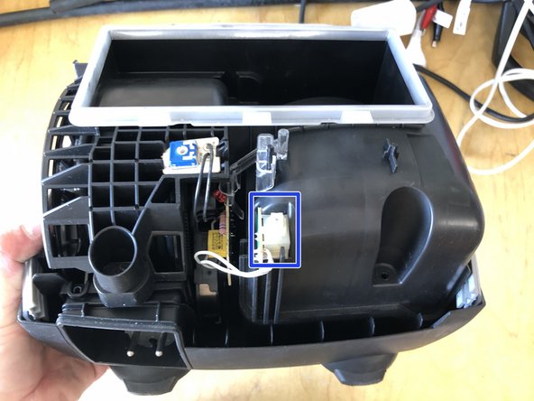

  5. Bosch Pro Animal BSGL5ZOO2 Motor Replacement, Remove top side of housing: crwdns2935265:05crwdnd2935265:01crwdnd2935265:02crwdne2935265:0 Bosch Pro Animal BSGL5ZOO2 Motor Replacement, Remove top side of housing: crwdns2935265:05crwdnd2935265:02crwdnd2935265:02crwdne2935265:0

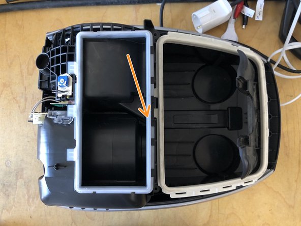

    • Lift the top of the housing from the handle side
    • Remove the top of the housing towards the rear.

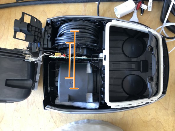

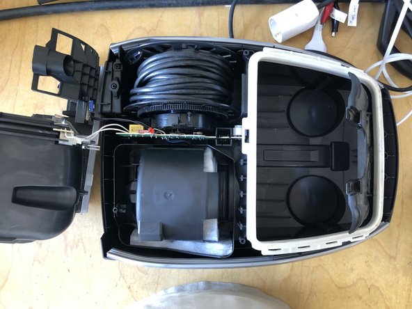

  6. Bosch Pro Animal BSGL5ZOO2 Motor Replacement, Remove motor cover: crwdns2935265:06crwdnd2935265:01crwdnd2935265:03crwdne2935265:0 Bosch Pro Animal BSGL5ZOO2 Motor Replacement, Remove motor cover: crwdns2935265:06crwdnd2935265:02crwdnd2935265:03crwdne2935265:0 Bosch Pro Animal BSGL5ZOO2 Motor Replacement, Remove motor cover: crwdns2935265:06crwdnd2935265:03crwdnd2935265:03crwdne2935265:0
    • Remove motor cover towards the back.
    • Carefully remove the circuit board from the guides of the cable drum.
    • The motor is now accessible.

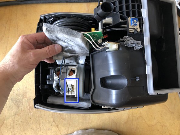

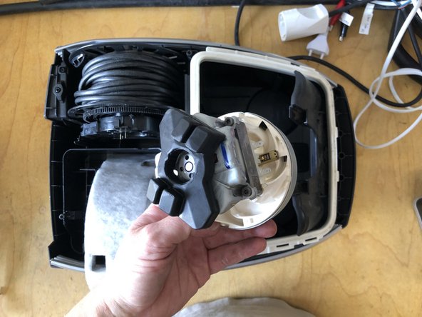

  7. Bosch Pro Animal BSGL5ZOO2 Motor Replacement, Removing the Motor: crwdns2935265:07crwdnd2935265:01crwdnd2935265:01crwdne2935265:0
    • Attention: Unplug the device from the power outlet!!
    • Removing the Motor
    • Disconnect the cables / terminals from the motor.
    • Dispose of the motor (scrap metal).

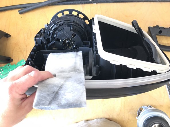

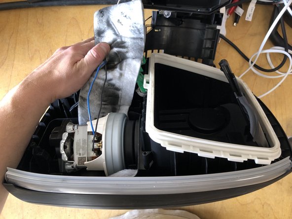

  8. Bosch Pro Animal BSGL5ZOO2 Motor Replacement, Inserting the Protective Fleece: crwdns2935265:08crwdnd2935265:01crwdnd2935265:02crwdne2935265:0 Bosch Pro Animal BSGL5ZOO2 Motor Replacement, Inserting the Protective Fleece: crwdns2935265:08crwdnd2935265:02crwdnd2935265:02crwdne2935265:0
    • Insert the protective fleece the right way around and with the cutouts properly aligned.

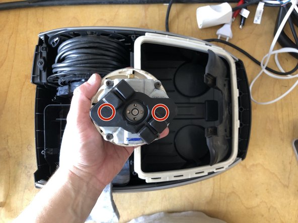

  9. Bosch Pro Animal BSGL5ZOO2 Motor Replacement, Preparing the Motor for Installation: crwdns2935265:09crwdnd2935265:01crwdnd2935265:03crwdne2935265:0 Bosch Pro Animal BSGL5ZOO2 Motor Replacement, Preparing the Motor for Installation: crwdns2935265:09crwdnd2935265:02crwdnd2935265:03crwdne2935265:0 Bosch Pro Animal BSGL5ZOO2 Motor Replacement, Preparing the Motor for Installation: crwdns2935265:09crwdnd2935265:03crwdnd2935265:03crwdne2935265:0
    • Unpack the new motor.
    • Checking the Fit of the Blower Seal
    • Insert the rubber mounts into the round cutouts.
    • Press the rubber mounts and the blower seal firmly into place.

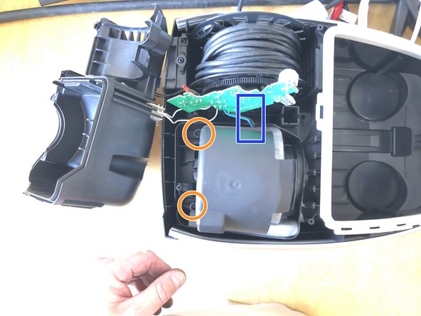

  10. Bosch Pro Animal BSGL5ZOO2 Motor Replacement, Installing the Motor: crwdns2935265:010crwdnd2935265:01crwdnd2935265:01crwdne2935265:0
    • Place and insert the motor with the rubber mount into the guide.
    • "Check that the motor is seated properly in the mount and in the housing.
  11. Bosch Pro Animal BSGL5ZOO2 Motor Replacement, Connecting the Motor: crwdns2935265:011crwdnd2935265:01crwdnd2935265:03crwdne2935265:0 Bosch Pro Animal BSGL5ZOO2 Motor Replacement, Connecting the Motor: crwdns2935265:011crwdnd2935265:02crwdnd2935265:03crwdne2935265:0 Bosch Pro Animal BSGL5ZOO2 Motor Replacement, Connecting the Motor: crwdns2935265:011crwdnd2935265:03crwdnd2935265:03crwdne2935265:0
    • Guide the cables through the cutouts in the fleece.
    • Firmly push the cables / spade connectors onto the terminals (there is no fixed assignment of the poles).

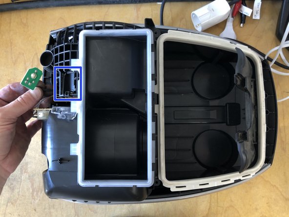

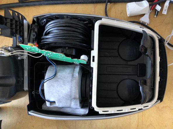

  12. Bosch Pro Animal BSGL5ZOO2 Motor Replacement, Preparing to Install the Control Board: crwdns2935265:012crwdnd2935265:01crwdnd2935265:02crwdne2935265:0 Bosch Pro Animal BSGL5ZOO2 Motor Replacement, Preparing to Install the Control Board: crwdns2935265:012crwdnd2935265:02crwdnd2935265:02crwdne2935265:0
    • Release the rotary dial's board from the holder (pull back the clip).
    • Place the control board on the fleece, in front of the guide rails.

  15. Bosch Pro Animal BSGL5ZOO2 Motor Replacement, Installing the Cover: crwdns2935265:015crwdnd2935265:01crwdnd2935265:03crwdne2935265:0 Bosch Pro Animal BSGL5ZOO2 Motor Replacement, Installing the Cover: crwdns2935265:015crwdnd2935265:02crwdnd2935265:03crwdne2935265:0 Bosch Pro Animal BSGL5ZOO2 Motor Replacement, Installing the Cover: crwdns2935265:015crwdnd2935265:03crwdnd2935265:03crwdne2935265:0
    • Place the cover on.
    • Clip the rotary dial's board into the holder.
    • Snap the cover into the holders by pressing it downwards.
