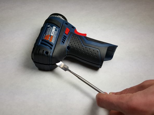

    2. Bosch PS21 Trigger Replacement: crwdns2935265:03crwdnd2935265:01crwdnd2935265:03crwdne2935265:0 Bosch PS21 Trigger Replacement: crwdns2935265:03crwdnd2935265:02crwdnd2935265:03crwdne2935265:0 Bosch PS21 Trigger Replacement: crwdns2935265:03crwdnd2935265:03crwdnd2935265:03crwdne2935265:0
      • Locate the eight 5.5 mm screws located on the upwards facing side of the drill.
      • Remove each screw using the T8 Torx driver, set aside in a safe place.
      • After removing all the screws, use a small or medium metal spudger remove the casing to expose the motor and trigger.

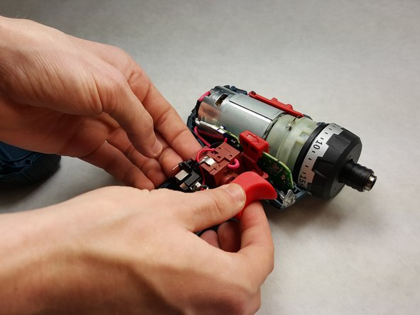

    3. Bosch PS21 Trigger Replacement: crwdns2935265:04crwdnd2935265:01crwdnd2935265:02crwdne2935265:0 Bosch PS21 Trigger Replacement: crwdns2935265:04crwdnd2935265:02crwdnd2935265:02crwdne2935265:0
      • Place a finger under the metal tab seen here and lift gently up to free the trigger mechanism.
      • Carefully grab the trigger assembly and gently pull upwards without taking too much out of place.

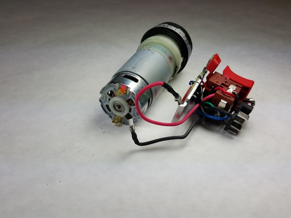

    4. Bosch PS21 Trigger Replacement: crwdns2935265:05crwdnd2935265:01crwdnd2935265:02crwdne2935265:0 Bosch PS21 Trigger Replacement: crwdns2935265:05crwdnd2935265:02crwdnd2935265:02crwdne2935265:0
      • Gently disconnect the two wires connecting the motor to the trigger utilizing a pair of pliers.
      • The trigger assembly is Part #:1607233422
