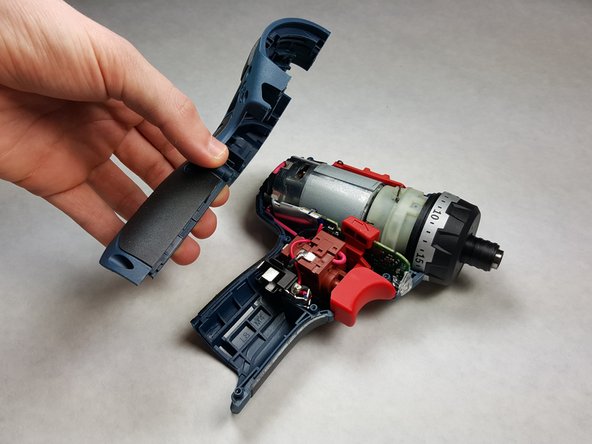

    3. Bosch PS21 Motor Replacement: crwdns2935265:04crwdnd2935265:01crwdnd2935265:02crwdne2935265:0 Bosch PS21 Motor Replacement: crwdns2935265:04crwdnd2935265:02crwdnd2935265:02crwdne2935265:0
      • Starting at the rear of the drill, use a wedge to separate the two halves of the outer case at the parting line.

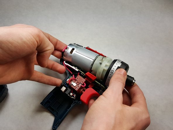

    4. Bosch PS21 Motor Replacement: crwdns2935265:05crwdnd2935265:01crwdnd2935265:02crwdne2935265:0 Bosch PS21 Motor Replacement: crwdns2935265:05crwdnd2935265:02crwdnd2935265:02crwdne2935265:0
      • The motor and trigger assembly are connected by two wires. Do not pull or put tension on these wires.
      • Lift up the metal tab as shown in the first picture to free the trigger assembly.
      • Gently dislodge the motor and trigger assembly from the drill case. Remove the components as one piece, shown in the second picture.

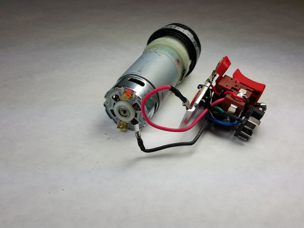

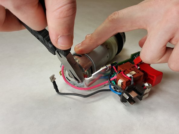

    5. Bosch PS21 Motor Replacement: crwdns2935265:06crwdnd2935265:01crwdnd2935265:03crwdne2935265:0 Bosch PS21 Motor Replacement: crwdns2935265:06crwdnd2935265:02crwdnd2935265:03crwdne2935265:0 Bosch PS21 Motor Replacement: crwdns2935265:06crwdnd2935265:03crwdnd2935265:03crwdne2935265:0
      • Be sure to not grip the pliers too firmly, as it could cause damage to the wire connectors.
      • Firmly secure the motor assembly in place. Using a set of pliers, carefully pull the black wire connector away from the motor. Repeat this action with the red wire connector.
      • The wire connections on the motor are color coded, matching the color wire that connects there.

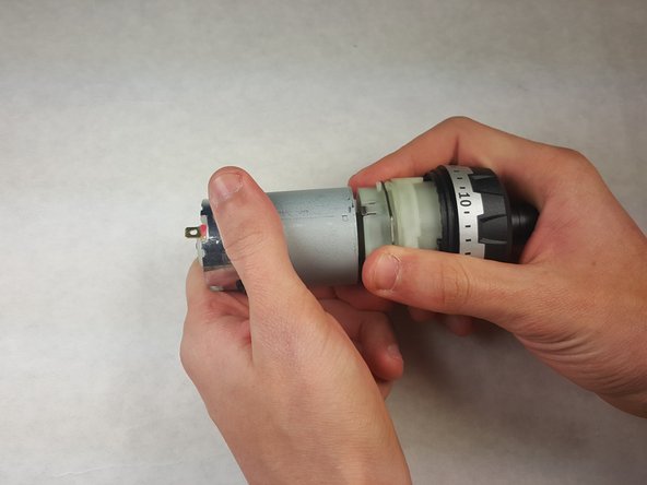

      • Once the wires have been disconnected, separate the trigger mechanism from the motor assembly.
      • Place your hands on each end of mechanism and carefully pull apart the assembly in order to separate the gearbox from the motor.
