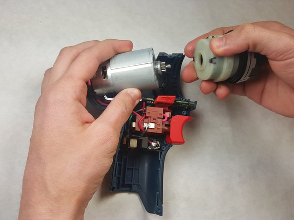

Bosch PS21 Gearbox (Clutch) Replacement
  1. Bosch PS21 Gearbox (Clutch) Replacement, Battery: crwdns2935265:01crwdnd2935265:01crwdnd2935265:01crwdne2935265:0
    • Pinch the two release tabs on the sides of the battery, and slide the battery out.
  2. Bosch PS21 Gearbox (Clutch) Replacement, Gearbox: crwdns2935265:02crwdnd2935265:01crwdnd2935265:02crwdne2935265:0 Bosch PS21 Gearbox (Clutch) Replacement, Gearbox: crwdns2935265:02crwdnd2935265:02crwdnd2935265:02crwdne2935265:0
    $3.99
    • Locate the clip that binds the two halves of the outer casing together on the rear edge of the battery shaft. Remove the clip with the angled tweezers.
  3. Bosch PS21 Gearbox (Clutch) Replacement: crwdns2935265:03crwdnd2935265:01crwdnd2935265:01crwdne2935265:0
    • Locate the eight 5.5 mm screws on the upwards facing side of the drill.
    • Remove each screw using the T8 Torx screwdriver and place them together in a safe place.
  4. Bosch PS21 Gearbox (Clutch) Replacement: crwdns2935265:04crwdnd2935265:01crwdnd2935265:02crwdne2935265:0 Bosch PS21 Gearbox (Clutch) Replacement: crwdns2935265:04crwdnd2935265:02crwdnd2935265:02crwdne2935265:0
    • Remove the upper portion of the case from the outer portion of the case using a metal spudger.
  5. Bosch PS21 Gearbox (Clutch) Replacement: crwdns2935265:05crwdnd2935265:01crwdnd2935265:02crwdne2935265:0 Bosch PS21 Gearbox (Clutch) Replacement: crwdns2935265:05crwdnd2935265:02crwdnd2935265:02crwdne2935265:0
    • Dislodge the motor assembly from the casing.
    • Remove the gearbox from the motor assembly.
