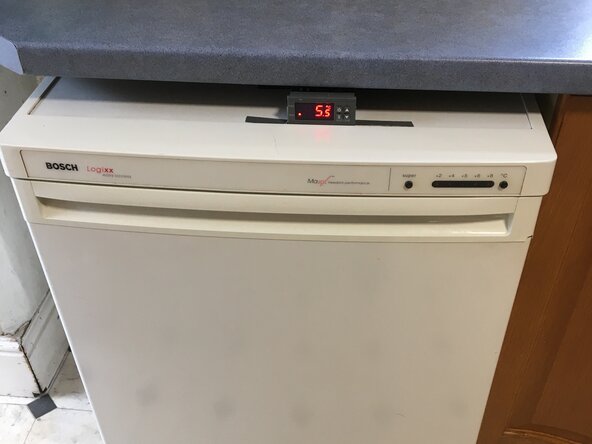

First image shows the small (150litre) basic fridge. The added digital room thermometer on top is useful but not essential. Disconnect power and pull fridge out from under counter to access the rear. No need to empty fridge, though it does make it easier to move. Fridge contents will remain cool for hours.

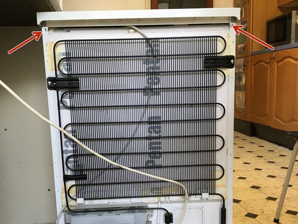

Second image shows the back of the fridge. Undo two Philips screws (red arrows). Lift the back of released panel slightly and push slightly forward and lift off and turn over. Note that there are cables attached to the top panel so twist it so it can lie upside down without straining the cables.

Optional second repair. To fully automate the temperature control throughout the seasons, an STC1000 temperature controller (see image) was added. (This should only be attempted by those with electrical knowledge, so only a brief outline is given here).

As a temporary measure, the wires and unit were duct taped in position. The unit could be hidden below the fridge's work-surface, once I am happy with the set up parameters. Alternatively, the stc1000 could be mounted on the side wall of the removable top section by cutting a rectangular opening, using the supplied mounting clips.
Note: There is an illuminated dot next to the word 'HEAT', though there is no active heater here and just means the fridge is naturally heating up as the compressor is off. When the dot next to the word 'COOL' is illuminated the compressor is on (if flashing, it is waiting to come on due to the compressor protection delay F3).
