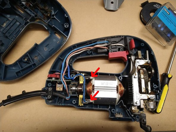

    • If you have disassembled the saw using the previous instructions, you can now access all of the components.
    • The Control board is at the rear. as shown in the main image. It can slide out now that the case is separated.
    • It is connected to the motor by two wires with copper push-in connectors, a blue one at the front and a white one at the other side, which is under the motor
    • There are two longer wires leading to push-in connectors on the switch, a black one and a white one. There is also a multi-pin connector for the speed control cable.

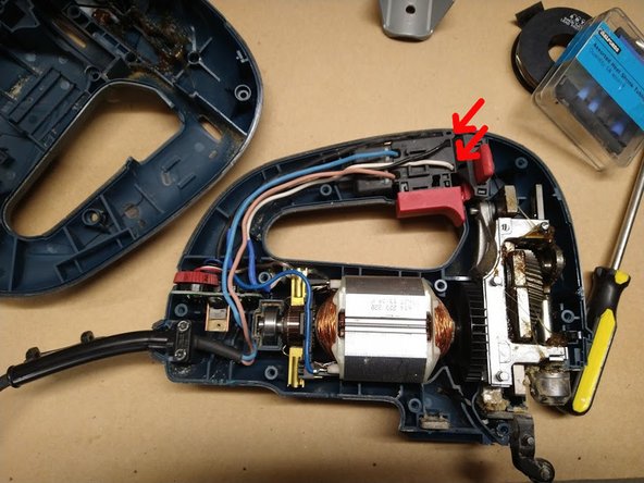

  9. Bosch GST90BE Jigsaw Speed Control Board Replacement, Optional Bypassing the speed control board: crwdns2935265:09crwdnd2935265:01crwdnd2935265:03crwdne2935265:0 Bosch GST90BE Jigsaw Speed Control Board Replacement, Optional Bypassing the speed control board: crwdns2935265:09crwdnd2935265:02crwdnd2935265:03crwdne2935265:0 Bosch GST90BE Jigsaw Speed Control Board Replacement, Optional Bypassing the speed control board: crwdns2935265:09crwdnd2935265:03crwdnd2935265:03crwdne2935265:0
    • If , like me, you never use the speed control on the Jigsaw, you can remove it permanently, and bypass it.
    • To do so, you will need to cut the wires between the switch and the PCB, and the PCB and the motor.
    • Then join the white wires together, and the black and blue wires together. The multi-pin connector is for the variable speed trigger and is not required.
    • I did this by soldering them together and covering the joints in Heat-shrink tubing.

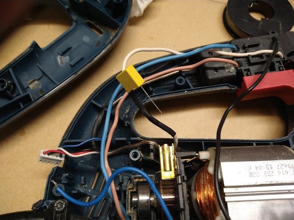

    • It is recommended to add an X2 0.1μF 310V capacitor between the white and black wires to prevent electrical noise and excessive sparking from the motor brushes, which would shorten the life of the motor, I did this by soldering one leg of the capacitor to the joint between the white cables and one to the joint between the blue and black wires.
    • Take care that the wires are routed correctly through the notches in the case frame, so they will not be compressed when you reassemble the saw
  10. Bosch GST90BE Jigsaw Speed Control Board Replacement: crwdns2935265:010crwdnd2935265:01crwdnd2935265:01crwdne2935265:0
    • Both joints and the capacitor legs should be covered in heat-shrink tubing to insulate them
