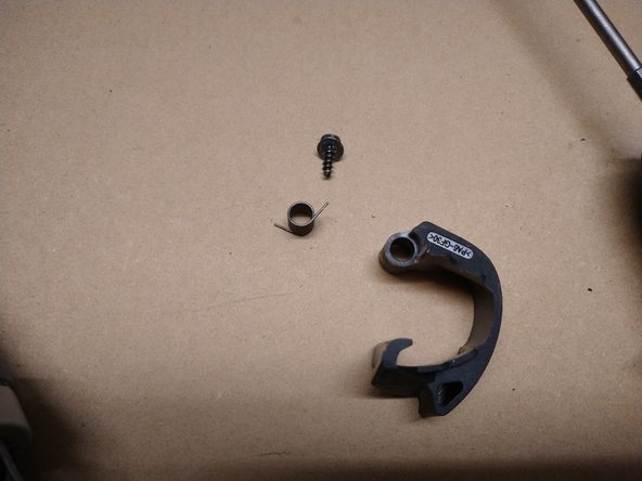

  3. Bosch GST90BE Jigsaw Disassembly, Remove blade lever: crwdns2935265:03crwdnd2935265:01crwdnd2935265:02crwdne2935265:0 Bosch GST90BE Jigsaw Disassembly, Remove blade lever: crwdns2935265:03crwdnd2935265:02crwdnd2935265:02crwdne2935265:0
    • Remove 1 T20 Torx screw and washer from blade lever, then remove blade lever and spring.

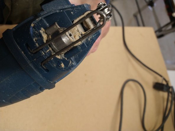

  4. Bosch GST90BE Jigsaw Disassembly, Remove metal cover and wire blade guard: crwdns2935265:04crwdnd2935265:01crwdnd2935265:03crwdne2935265:0 Bosch GST90BE Jigsaw Disassembly, Remove metal cover and wire blade guard: crwdns2935265:04crwdnd2935265:02crwdnd2935265:03crwdne2935265:0 Bosch GST90BE Jigsaw Disassembly, Remove metal cover and wire blade guard: crwdns2935265:04crwdnd2935265:03crwdnd2935265:03crwdne2935265:0
    • Remove 2 Posidriv screws from front cover, then slide off front cover and remove wire blade guard, which rests in a recess behind the metal cover.
    • Remove one Torx T20 screw
