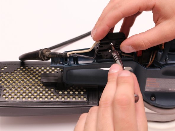

    • Ensure that the power chord is not plugged into an outlet.
    • Using the T20 Torx Screwdriver, remove the four 15.6 mm screws securing the top cover to the sander.
    • Lift the top cover off the sander.
  2. Bosch 3727DEVS Power Cord  Replacement: crwdns2935265:02crwdnd2935265:01crwdnd2935265:03crwdne2935265:0 Bosch 3727DEVS Power Cord  Replacement: crwdns2935265:02crwdnd2935265:02crwdnd2935265:03crwdne2935265:0 Bosch 3727DEVS Power Cord  Replacement: crwdns2935265:02crwdnd2935265:03crwdnd2935265:03crwdne2935265:0

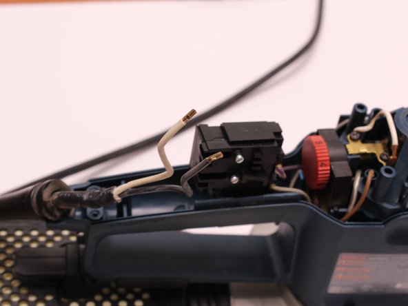

    • Using the T20 Torx Screwdriver, remove the two 15.6 mm screws securing the cable clip to the motor housing.
    • Lift cable clip and cord from motor housing.
  3. Bosch 3727DEVS Power Cord  Replacement: crwdns2935265:03crwdnd2935265:01crwdnd2935265:03crwdne2935265:0 Bosch 3727DEVS Power Cord  Replacement: crwdns2935265:03crwdnd2935265:02crwdnd2935265:03crwdne2935265:0 Bosch 3727DEVS Power Cord  Replacement: crwdns2935265:03crwdnd2935265:03crwdnd2935265:03crwdne2935265:0
    $5.49
    • Using the 2.5 mm Flathead Screwdriver, loosen the two screws securing the white and black wires to the On/Off Switch.
Daniel Riddle
