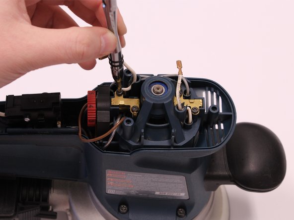

    • Remove the two white wires connected to each motor brush by pulling on the spade terminals.
  3. Bosch 3727DEVS Motor Brushes  Replacement: crwdns2935265:03crwdnd2935265:01crwdnd2935265:03crwdne2935265:0 Bosch 3727DEVS Motor Brushes  Replacement: crwdns2935265:03crwdnd2935265:02crwdnd2935265:03crwdne2935265:0 Bosch 3727DEVS Motor Brushes  Replacement: crwdns2935265:03crwdnd2935265:03crwdnd2935265:03crwdne2935265:0

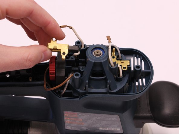

    • Using the T10 Torx Screwdriver, remove the four 9.7 mm screws securing the motor brushes to the housing.
    • After the screws are removed, both motor brushes can be lifted out of their position by hand.
