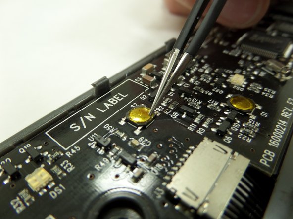

    1. Boogie Board Rip Copper Button Plate Replacement, Copper Button Plate: crwdns2935265:07crwdnd2935265:01crwdnd2935265:02crwdne2935265:0 Boogie Board Rip Copper Button Plate Replacement, Copper Button Plate: crwdns2935265:07crwdnd2935265:02crwdnd2935265:02crwdne2935265:0
      • Using tweezers gently go around the edges of the copper plate to remove the adhesive.

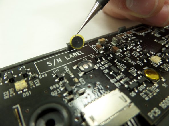

    2. Boogie Board Rip Copper Button Plate Replacement: crwdns2935265:08crwdnd2935265:01crwdnd2935265:02crwdne2935265:0 Boogie Board Rip Copper Button Plate Replacement: crwdns2935265:08crwdnd2935265:02crwdnd2935265:02crwdne2935265:0
      • Use tweezers to grip the outer edge of the copper plate and lift the button straight off.
