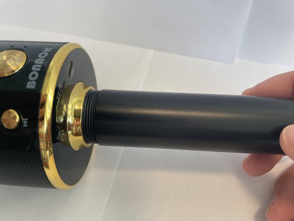

  1. Bonaok Q37 Battery Replacement, Battery: crwdns2935265:01crwdnd2935265:01crwdnd2935265:01crwdne2935265:0
    • Power down the microphone before proceeding to the next step.
  2. Bonaok Q37 Battery Replacement: crwdns2935265:02crwdnd2935265:01crwdnd2935265:02crwdne2935265:0 Bonaok Q37 Battery Replacement: crwdns2935265:02crwdnd2935265:02crwdnd2935265:02crwdne2935265:0
    • Hold the handle with your right hand and unscrew towards you.
    • Once the cover is unscrewed completely, remove the handle cover.

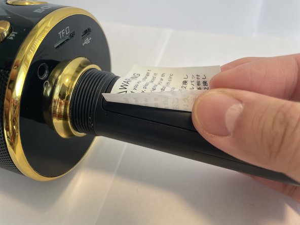

  3. Bonaok Q37 Battery Replacement: crwdns2935265:03crwdnd2935265:01crwdnd2935265:02crwdne2935265:0 Bonaok Q37 Battery Replacement: crwdns2935265:03crwdnd2935265:02crwdnd2935265:02crwdne2935265:0
    • Lift up the side edges of the "Caution" sticker to unseal the battery cover.
    • If the battery compartment cover is not sealed with a caution sticker, proceed to Step 4.

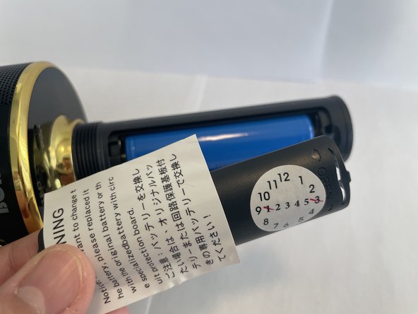

  4. Bonaok Q37 Battery Replacement: crwdns2935265:04crwdnd2935265:01crwdnd2935265:02crwdne2935265:0 Bonaok Q37 Battery Replacement: crwdns2935265:04crwdnd2935265:02crwdnd2935265:02crwdne2935265:0
    • Use a pair of tweezers to push the cover towards the left.
    • Lift up the cover to remove it from the microphone.

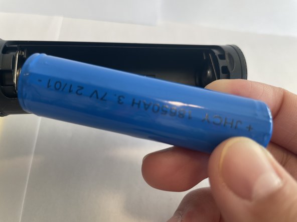

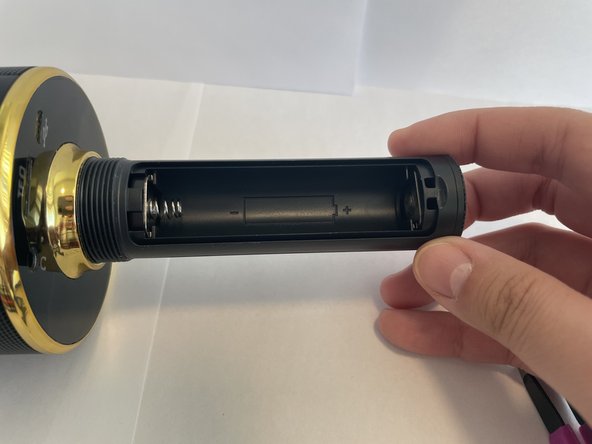

  5. Bonaok Q37 Battery Replacement: crwdns2935265:05crwdnd2935265:01crwdnd2935265:03crwdne2935265:0 Bonaok Q37 Battery Replacement: crwdns2935265:05crwdnd2935265:02crwdnd2935265:03crwdne2935265:0 Bonaok Q37 Battery Replacement: crwdns2935265:05crwdnd2935265:03crwdnd2935265:03crwdne2935265:0
    • Push the battery towards the left and lift it up from the (+) side.
    • Remove the battery from the compartment.
  6. Bonaok Q37 Battery Replacement: crwdns2935265:06crwdnd2935265:01crwdnd2935265:01crwdne2935265:0
    • Insert a new battery into the compartment.
    • Make sure you insert the (-) end first, then push towards the left to make room for the whole battery to be pushed into the compartment.

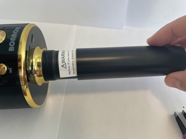

  7. Bonaok Q37 Battery Replacement: crwdns2935265:07crwdnd2935265:01crwdnd2935265:03crwdne2935265:0 Bonaok Q37 Battery Replacement: crwdns2935265:07crwdnd2935265:02crwdnd2935265:03crwdne2935265:0 Bonaok Q37 Battery Replacement: crwdns2935265:07crwdnd2935265:03crwdnd2935265:03crwdne2935265:0
    • Close the lid and seal back with the caution sticker.
    • Screw the handle back on by twisting it away from you.

Which type of battery? I looked on Amazon but can't find it. Must be age related problem, too old for new tech. 😊
Carmen Veguilla - crwdns2934203:0crwdne2934203:0
Where can I buy replacement battery
Lee Fisher - crwdns2934203:0crwdne2934203:0
NUMBER 18650 3.7volt lithium-ion rechargeable, available online everywhere BUT cannot ship with most carriers so delivery charge is expensive
