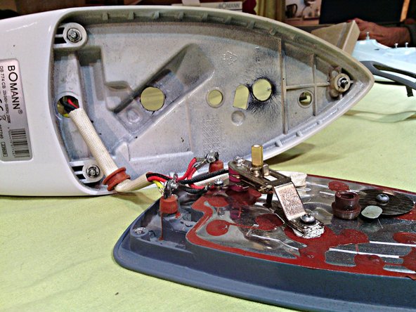

  3. Bomann DB 774CB Iron, Stripping of the sole: crwdns2935265:03crwdnd2935265:01crwdnd2935265:02crwdne2935265:0 Bomann DB 774CB Iron, Stripping of the sole: crwdns2935265:03crwdnd2935265:02crwdnd2935265:02crwdne2935265:0
    • Remove the screws and remove the plastic shell.
    • Unscrew the screws and remove the base cover.
  4. Bomann DB 774CB Iron, Breakdowns: crwdns2935265:04crwdnd2935265:01crwdnd2935265:01crwdne2935265:0
    • Two different failures already observed:
    • Spacer (circled) which had come out of its housing following a fall of the iron!
    • Small foreign body that got stuck between the two contacts (circled).
    • Be careful not to turn the temperature adjustment screw (arrow) located in the control rod. Its readjustment is quite tedious, by mistake and trials!
Putting each screw back in its place is no problem.
