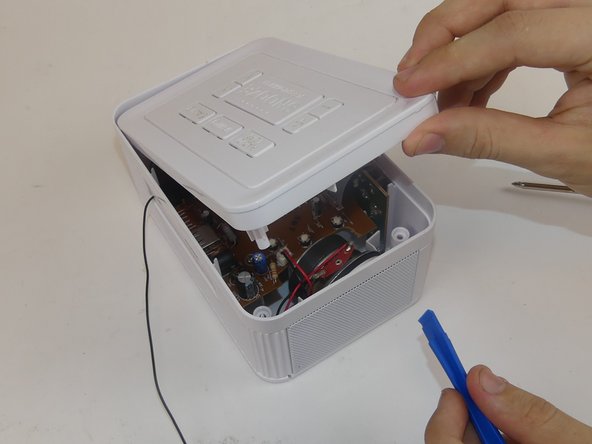

  3. Bolide Technology Group Dual Alarm Clock Speaker Replacement: crwdns2935265:03crwdnd2935265:01crwdnd2935265:03crwdne2935265:0 Bolide Technology Group Dual Alarm Clock Speaker Replacement: crwdns2935265:03crwdnd2935265:02crwdnd2935265:03crwdne2935265:0 Bolide Technology Group Dual Alarm Clock Speaker Replacement: crwdns2935265:03crwdnd2935265:03crwdnd2935265:03crwdne2935265:0
    • Grab your nylon pry tool and wedge it between the outer case and the top of the radio. Slowly pry open the top and remove it.
    • This may be more difficult to take off if the top hasn't been removed before, but it may be easier to turn the clock upside down for this step.

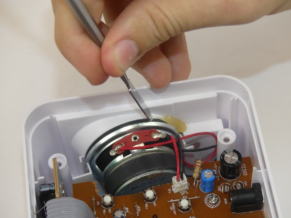

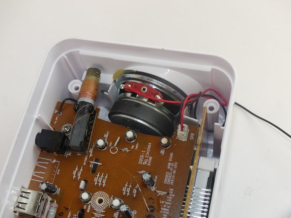

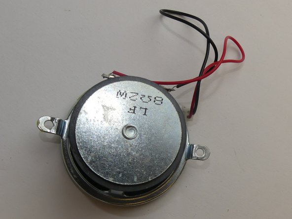

    • Using a black nylon spudger to carefully break the glue around the outside of the speaker so it can be dislodged.

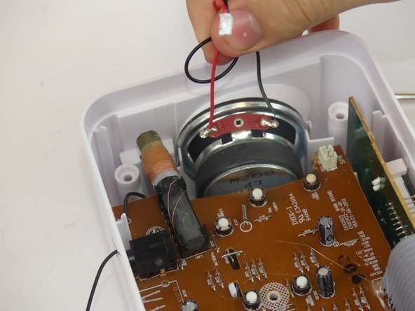

  5. Bolide Technology Group Dual Alarm Clock Speaker Replacement: crwdns2935265:05crwdnd2935265:01crwdnd2935265:03crwdne2935265:0 Bolide Technology Group Dual Alarm Clock Speaker Replacement: crwdns2935265:05crwdnd2935265:02crwdnd2935265:03crwdne2935265:0 Bolide Technology Group Dual Alarm Clock Speaker Replacement: crwdns2935265:05crwdnd2935265:03crwdnd2935265:03crwdne2935265:0
    • Locate the speaker plug for the speaker you wish to remove and slightly tug on it until it becomes unplugged
    • This can also be done with a pair of tweezers if you find there isn't enough space.

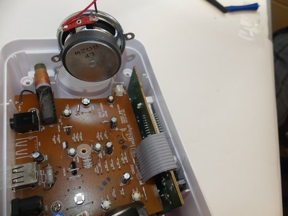

  6. Bolide Technology Group Dual Alarm Clock Speaker Replacement: crwdns2935265:06crwdnd2935265:01crwdnd2935265:02crwdne2935265:0 Bolide Technology Group Dual Alarm Clock Speaker Replacement: crwdns2935265:06crwdnd2935265:02crwdnd2935265:02crwdne2935265:0
    • After the speaker cord is removed, pull the speaker straight up and out of the radio.

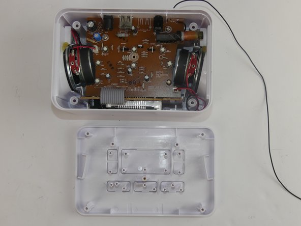

  7. Bolide Technology Group Dual Alarm Clock Speaker Replacement: crwdns2935265:07crwdnd2935265:01crwdnd2935265:02crwdne2935265:0 Bolide Technology Group Dual Alarm Clock Speaker Replacement: crwdns2935265:07crwdnd2935265:02crwdnd2935265:02crwdne2935265:0
    • Once the speaker is removed, the inside of the dual alarm clock should look identical to the photo shown.
