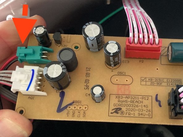

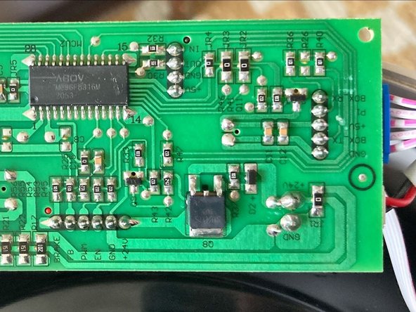

  4. Blueair 311 Auto: Disassembly and disconnection of ionizer, Disconnect the ionizer power cable: crwdns2935265:04crwdnd2935265:01crwdnd2935265:03crwdne2935265:0 Blueair 311 Auto: Disassembly and disconnection of ionizer, Disconnect the ionizer power cable: crwdns2935265:04crwdnd2935265:02crwdnd2935265:03crwdne2935265:0 Blueair 311 Auto: Disassembly and disconnection of ionizer, Disconnect the ionizer power cable: crwdns2935265:04crwdnd2935265:03crwdnd2935265:03crwdne2935265:0
    • Unclip the connector for the 2-wire ionizer power cable, and disconnect if from the printed circuit board (PCB)
    • Note: It is possible & easier to unclip the connector, without fully removing the PCB, i.e. by reaching behind the PCB, and applying pressure purely by the feeling of the clip, to unclip it. These photos are just for clarity.
