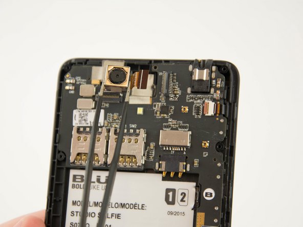

  7. Blu Studio Selfie Rear Facing Camera Replacement, Rear Facing Camera: crwdns2935265:07crwdnd2935265:01crwdnd2935265:02crwdne2935265:0 Blu Studio Selfie Rear Facing Camera Replacement, Rear Facing Camera: crwdns2935265:07crwdnd2935265:02crwdnd2935265:02crwdne2935265:0
    • Flip up the retaining flap on the camera cable ZIF connector.
    • Pull the camera's ribbon cable straight out of its socket.
    • Gently remove the rear facing camera.
