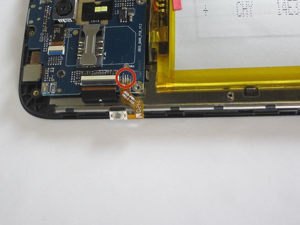

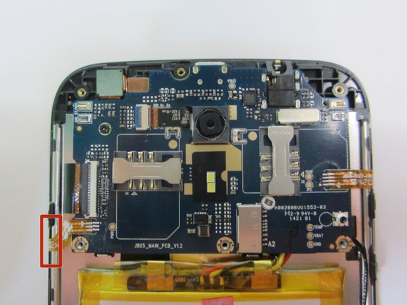

    1. Blu Studio HD 6.0 Power Button Replacement, Locate the power button.: crwdns2935265:08crwdnd2935265:01crwdnd2935265:01crwdne2935265:0
      • The power button is located on the rear-left side of your phone just above the battery.
    2. Blu Studio HD 6.0 Power Button Replacement, Separate the old button.: crwdns2935265:09crwdnd2935265:01crwdnd2935265:02crwdne2935265:0 Blu Studio HD 6.0 Power Button Replacement, Separate the old button.: crwdns2935265:09crwdnd2935265:02crwdnd2935265:02crwdne2935265:0
      • Lift the button very carefully.
      • Then unsolder the connections.
    3. Blu Studio HD 6.0 Power Button Replacement, Solder the new button.: crwdns2935265:010crwdnd2935265:01crwdnd2935265:02crwdne2935265:0 Blu Studio HD 6.0 Power Button Replacement, Solder the new button.: crwdns2935265:010crwdnd2935265:02crwdnd2935265:02crwdne2935265:0
      • Solder the new power button in the spot shown in the picture.
      • Fit the button on the side of the phone.
