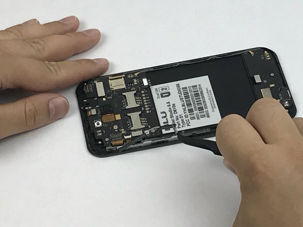

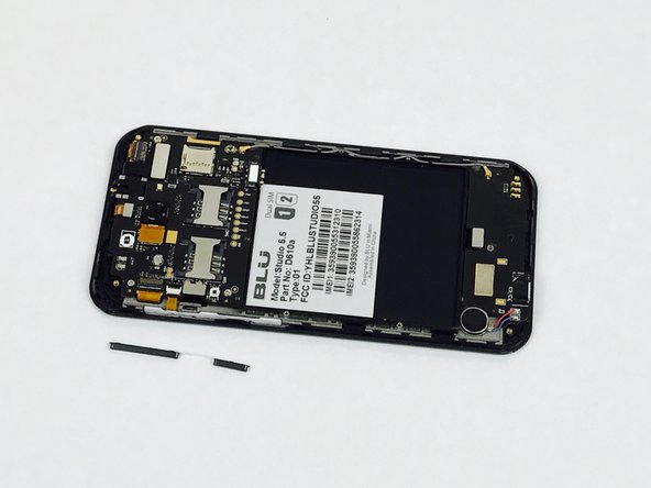

  6. Blu Studio 5.5 Volume Control Replacement, Volume Control: crwdns2935265:06crwdnd2935265:01crwdnd2935265:03crwdne2935265:0 Blu Studio 5.5 Volume Control Replacement, Volume Control: crwdns2935265:06crwdnd2935265:02crwdnd2935265:03crwdne2935265:0 Blu Studio 5.5 Volume Control Replacement, Volume Control: crwdns2935265:06crwdnd2935265:03crwdnd2935265:03crwdne2935265:0
    • Once the back panel is removed, locate the volume controller.
    • Grab the volume controller with either your fingers or tweezers and gently remove from the phone.
    • Set replaced volume controller aside and gently insert replacement controller.
